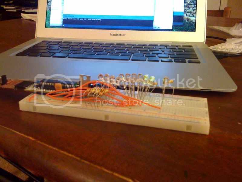

. . . and I just finished soldering together a RBBB kit, my first ever Arduino (or microcontroller of any kind, really.) It's running blink right now.
Wife and kids are in bed.
I have a pile of LEDs, a pile of resistors, and a big solderless breadboard in front of me. My goal: build and program a binary clock by midnight.
Wish me luck. Here goes! :slight_smile:
Done, with half an hour to spare!
Though, there's something weird going on. It never gets past 3 minutes. I'm guessing I have a typo in my code, so I'll start troubleshooting it.

Of course! Doh! I had a bunch of == where I should have had =.
Corrected:

My next attempt will do something more elegant in place of that big ugly if statement. Also, I have a DS1307 RTC that I want to integrate into this project. I figure I'll have it check the RTC once a day or something and "calibrate" against the RTC's time.
I guess I get to post in the exhibition forum now, huh? I posted here expecting this thread to be a generic rumination about this being my first microcontroller project, but lo and behold, I actually accomplished something. Thanks to the Arduino team (and Modern Device, for my RBBB kit) for putting such a great set of tools together.
Woo Hoo! Coded and debugged ahead of schedule!
Take the rest of the day off! :slight_smile:
Doh! again. There are still problems - I don't reset the states correctly when minutes or hours rolls over. Oh well, something to work out tomorrow night.

Seriously though, it's scary how easy this stuff is. I figured this binary clock project would keep me busy for a week or two, but it only really lasted 3 hours, even accounting for debugging tomorrow! ;D
Welcome to the hobby, it can be quite fun and a time sink at the same time. There are always new libraries and external devices to explore and each new challenge can lead to another.

Debugged this morning. I hadn't synchronized the "counters" for each time segment with the LED state variables. So I was getting weird behavior - 13:61 instead of 1:01 AM, for instance.
