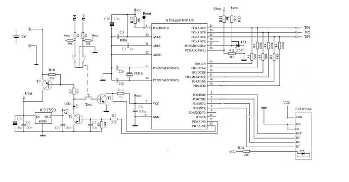

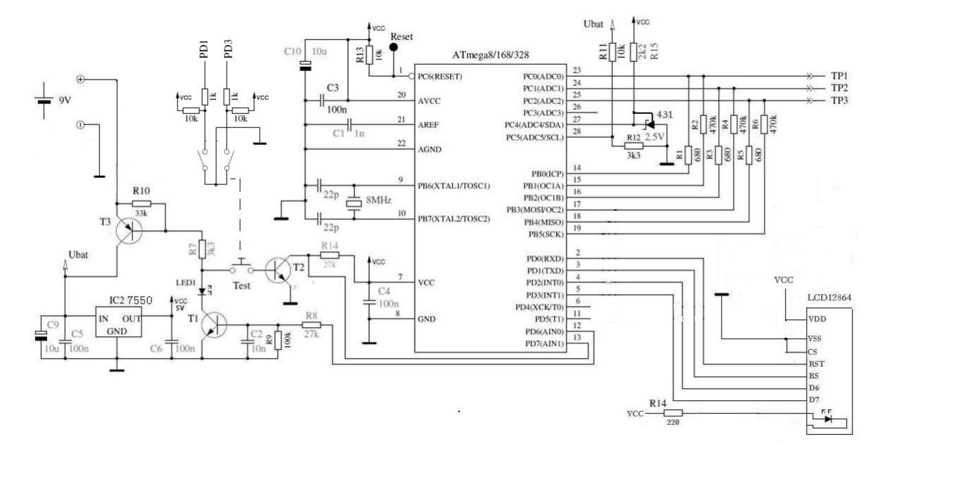

Tracing the schematic... also attached
RST was connected to RX Pin 0
CS To TX Pin1
D7 To Pin 2 Int
D6 To Pin 3 Int
The other 4 pins are for powering the Display ( I presume !!)

Schematic: This does not look like an Arduino Board. How is the schematic related to your questions?

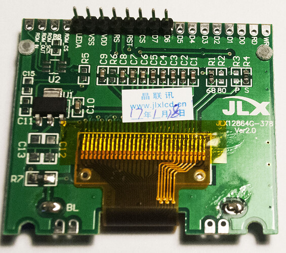

Display PCB: The ST7565 supports several communication interfaces (parallel, SPI, I2C). Usually the type of the interface can be changed on the PCB by changing solderbridges there. Please post a picture of the back side of your display to identify the interface type.

The processor in the schematic is ATmega8/168/328 which is an arduino compatible
Here is the Display
If you need a better picture ...please let me know....and I will do it
Here is a better picture ...I hope !!

According to the picture, your display is configured in 4-wire SPI mode.
