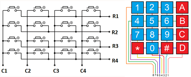

What would a matrix output entail? I don't mind hard. I prefer to take my time and do something clean rather than having extra buttons that would be difficult to use.
A matrix output means each button connects one row line to one column line it never goes to GND. To use it properly, you’d need to find the two lines that belong to that button and detect when they’re shorted during the scan.
Example:in the matrix, the “A” button might just connect Row 2 to Column 4 for a moment, not GND.
It’s doable, just more reverse-engineering than simple wiring. If you want, I can tell you how to find those two lines.

If I do manage to find the correct traces, would that mean that each button would need 2 wires that would then be connected each to one pin of the arduino?
Yes each button in a matrix is basically a pair.
So you’d take two wires, one from the row line and one from the column line, and bring both into the Arduino.
The Arduino doesn’t read “pressed = GND”; it reads “these two lines are shorted”.
That’s just how matrix buttons work

I'm facing another problem apparently. I resoldered the wires to a pad on each side of each buttton. When I press, they short. So far so good.
Problem is, one pad of one button A seems connected to button B.
Buttons in matrices are connected to each other.
That usually means the buttons share a common trace on the PCB many Joy-Con buttons aren’t fully isolated. One pad is the signal and the other pad is part of a shared matrix or a shared ground line. So measuring continuity between pads of different buttons is normal in that case.
What matters is that only the signal pad goes to your input pin, and the shared pad goes to GND. If both pads of two buttons are tied together, you probably picked the wrong pad try probing the PCB and locate the pad that actually changes when you press the button. Sometimes only one of the two pads is the real switch line and the other is part of a common bus.
If you’re unsure: set your multimeter to continuity, put one probe on GND of the board, and find which pad beeps. That one is the common pad ignore it and use the other pad for your button signal
