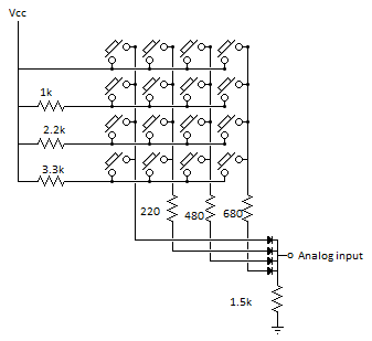

Questions:
  1. I want to use 20 buttons. I can make it work with 10 buttons on A0, but I need 10 more.
    Then I try to put in a code for A1, but no luck with that.
    I also wonder, if it is possible to add an analog potentiometer to A2?
Please, can anyone give me some advice?

  1. I want to use 20 buttons. I can make it work with 10 buttons on A0, but I need 10 more. Then I try to put in a code for A1, but no luck with that.
The buttons on A1 should work the same as the buttons on A0.
Yes.
  1. LEDs: How can I assign 20 LEDs - one for each button?
    Since you don't have 20 spare output pins you will need to either add hardware or find 10 spare pins to make a matrix (5 rows and 5 columns) or find five spare pins and learn about Charlieplexing.
  1. Is it possible to use the same Pro Micro for the above and MIDI to USB?
    Depends on what you mean by "MIDI to USB". Can you point to an example?
randomSeed(analogRead(1));
As you are wiring up analog 1 then it is not going to give you a random seed is it.
But that code only ever reads A1, never A0.
Are you saying that if you change it and the wires to A0 this works?
If so you are not swapping over the wiring correctly or your A1 input channel is shot.
Also that code has an unmatched number of braces so it doesn't even compile. It is important you post your code not something "like" it.
int Button[21][3]
Is defined in the setup function and so is not valid anywhere else.
There is lots more wrong with that code. Start simple and test and build up code do not try and write it all at once.

Multiply (20) buttons:
I have two 10 resistor ladder, as showen i the following code (I have left out the LED code and some of the code due to maximun characters)
I´m using the same resistor value in the two ladders.
The reason for that is to get the analog read so stabil as possible.
My problem is to define the code for:
"int Button[21][3] = "
and the analog inputs:
"int analogpin = A1; // analog pin to read the buttons"
Can´t compile, because it only can be defined one time.
In addition to this, I also want to attach an analog 10K potentiometer.
It´s also the same problem I´m running into with this.
How can I make this work?

I found a 4X4 matrix keypad on Youtube, and I have made my own 4X4 matrix keypad, using my heavy duty foot switdhes. Please see the attatched picture for schematic.
After compiling the code, I noticed this:
Global variables use 193 bytes (7%) of dynamic memory, leaving 2,367 bytes for local variables.
Maximum is 2,560 bytes
Is that something I should be worried about and what´s the reason for this?
Perhaps this:
ret=15-(log((analogRead(A0)-183.9)/58.24)/0.1623)+0.5;
And I also noticed, that it sometimes don´t send the expected character. Don´t know if it is the code or my homemade keypad, there is causing this. - any suggestions would be very much appreciated.
I have to mention, that I´m planning to add an LED matrix (John suggested Charliepkexing), just to show which button there have been pushed.
What do you think about it?
