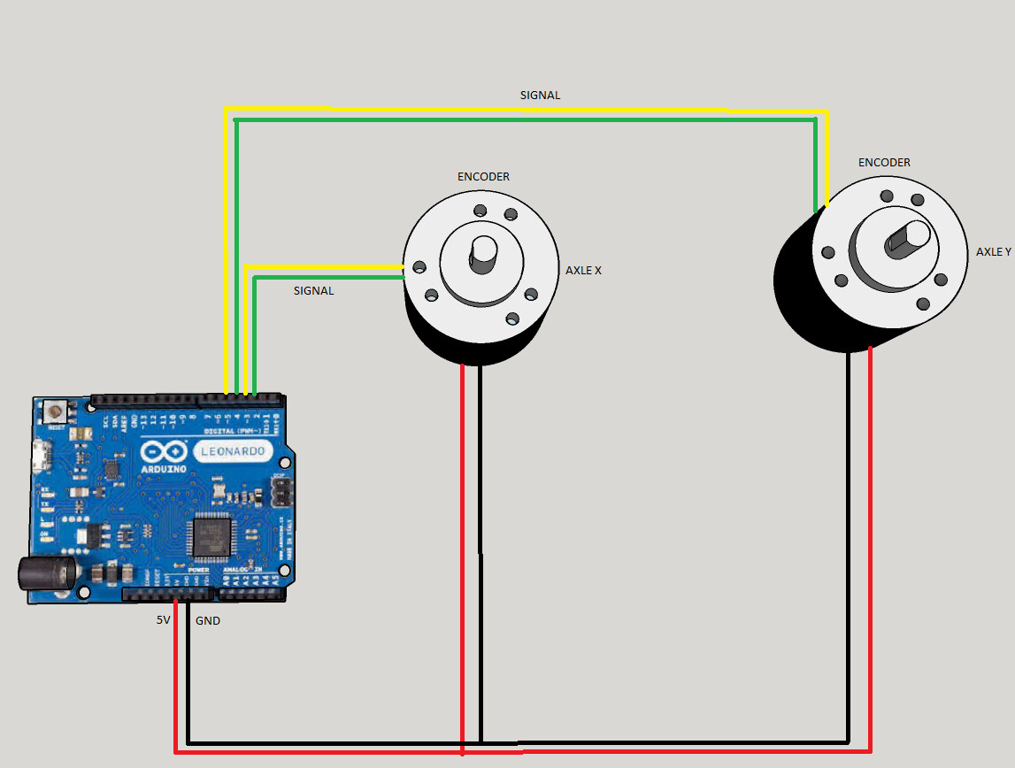

I'm developing a sidestick for flight simulation and I'm using two encoders, one on digital ports 2 and 3 and another on ports 4 and 5, but I haven't had success with the programming yet! I would like you to give me a light on how to read these values ​​in these ports, would you like to get the X, Y axes? Note: I'm using not only the joystick.h library but also the Encoder library.

Hi, @edmarpmc
Welcome to the forum.
Can you please post your complete code and not just the start it?
What model Arduino are you using?
Can you please post link to data/specs of your encoders?
Can you please post an image(s) of your project?
Please include ALL hardware, component names and pin labels.
Can you place Serial.print statements in your code to use as debug through the IDE monitor?
You have 2 calls to Joystick.setXAxis(). I am guessing that one of them should be Joystick.setYAxis()

Hello goodnight
I have this new code, when I move the X axis it moves, but when I move the Y axis it doesn't move and the X axis stops as well! I don't have much experience with arduino, I must be wrong somewhere. I also send you the schematic in .jpg, if you can help me, thank you in advance!
![Esquema|660x499](upload://45yJMQih7AerR9JX5r5lOgPs3Ud.jpeg)
