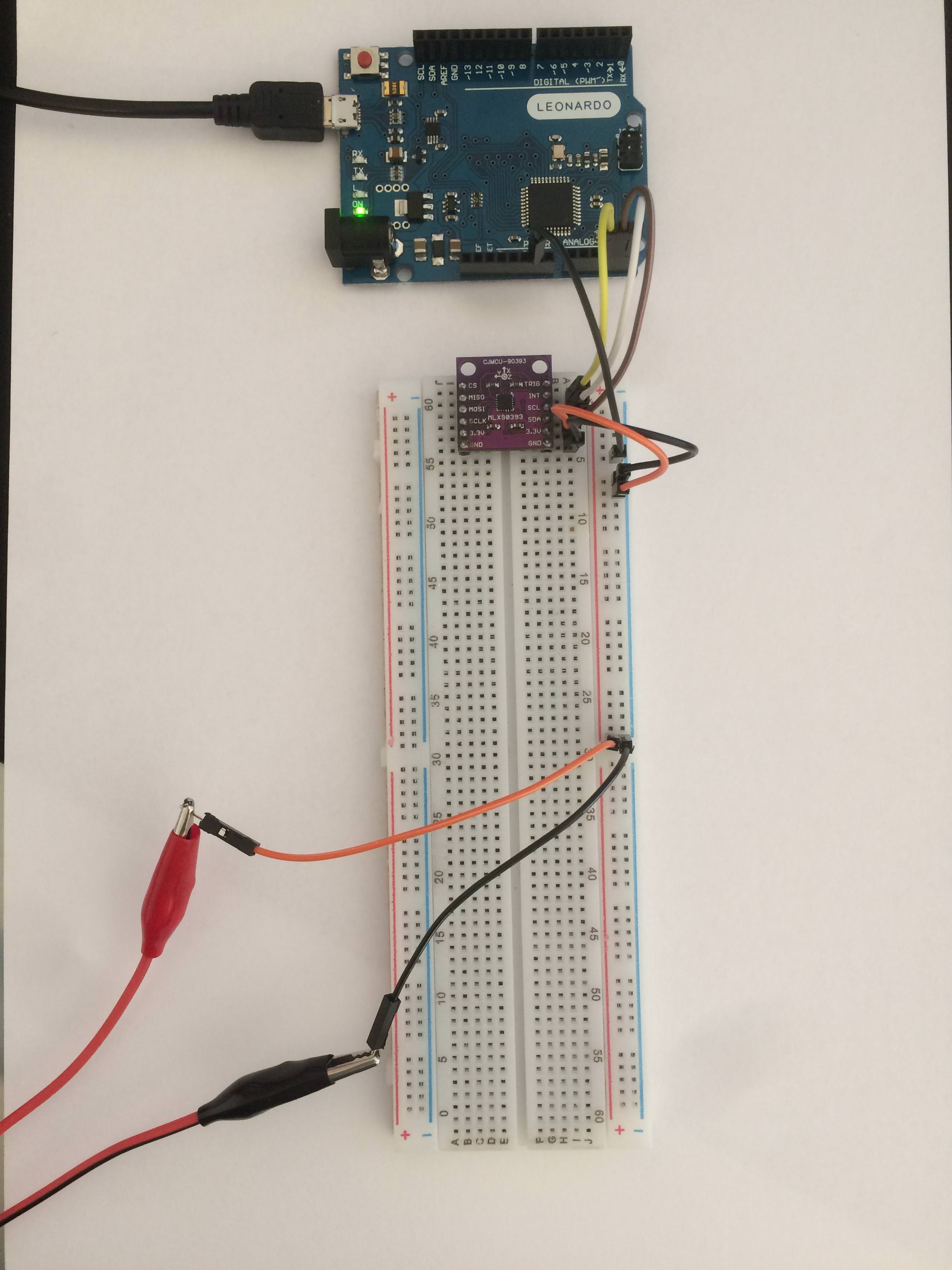

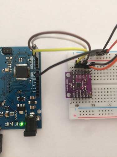

I use an Arduino Leonardo and a breakout module for the MLX90393.
But all I get in the serial monitor is "Start status: 0x11111111" and then nothing else happens
or if I just take out the sensor module of the breadboard I get unrealistic high values (440°C at room temperature).
That tells me that the sensor is doing something but that it is unable to execute the main loop or is getting stuck in the setup.
I would be really happy if anyone could help me here because I don't know what is the error here.
Pictures below for circuit:
Sensor is powered externally by 3.3V
EDIT:
Reconnect SDA to the SDA pin and SCL to the SCL pin on the Leonardo but still not working.
Edited the code so I get the line as output were the programm is currently at
and it gets stuck on "mlx.readData(data);" in line 51.
