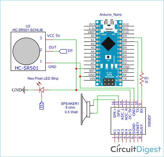

this project talking xmas tree connects JQ6500 audio module to pins D8 + D9 ...But these are both PWM. I need all the PWM pins to connect servos and add some animatronic to this project. My question is can JQ6500 be connected to a non PWM digital pin ? please advice..
The lines to that are are for using software serial, so again any two lines will do, but avoid using pins 0 and 1 as they are for the hardware serial output.
