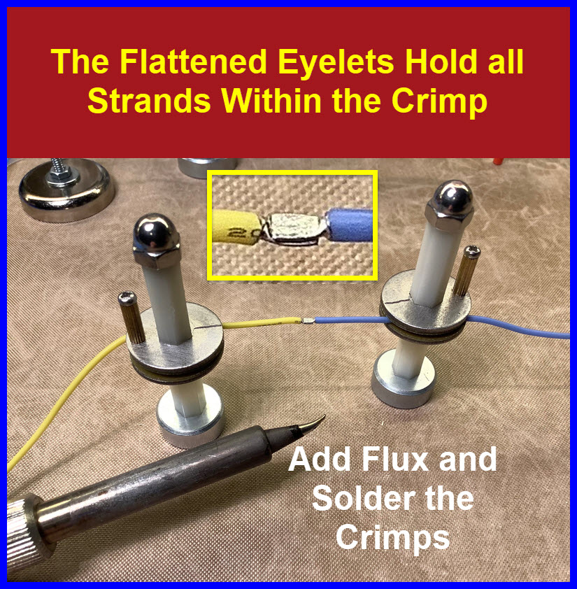

Wire splicing idea:
In my cart. Thanks.
Thanks - looks like the PDF is a good solution for now, plus I can make the wires any length.
