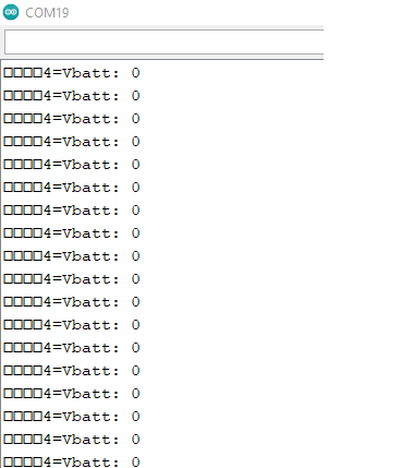

and below is the display
display

It's not very clever to run the Modbus serial on the same interface you use to communicate the values to the PC (and for debugging). The Mega has 4 (!) hardware serial interface so I recommend to use another one than the PC connection (p.e. Serial1 and TX1/RX1).

and the serial output is blank.
