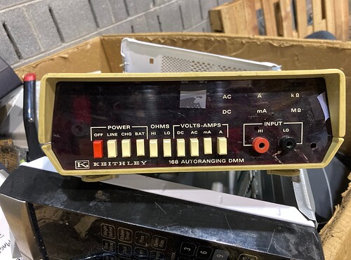

Keithley 168 "repair"
Yes. that is right. I have a Keithley 168 scope
that is in unknown condition.

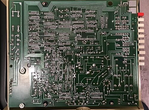

However, the section "how to check batteries" invalidate the previous assumptions because the test pad B is connected to pole C (which is supposedly 0V, connected to the negative lead of the two BA-29 batteries), as shown on the picture of the PCB.
Which means that either figure 8 is wrong, or Table 2-2 and the description is wrong.
Which lead to my attempt to figure out which battery lead is connected to "ground", so I start to probe the battery pins and the "Lo" pin (or GND).
So far, I have found that pin A is connected to GND when the device is NOT in "CHG" mode. Which is supported by the fact that when charging, the battery is connected in series (manual). Which suggest that the two BA-29 battery should be connected from A to B (B being the positive end of the BA-29), rather than the other way around and also validates the fact that the battery probe is on pole B.

I don't think so. What does the front panel say?
Note: the board is REV J, which is likely a long way from your schematic.
More notes: If the batteries are really listed as 1.2 volts, they are the REALLY old NICAD cells.
I think they are 1.2 because they are rechargeable. Modern 1.2V Ni-Mh is also rated at that voltage.
Of course it is old. It's year 1975, if I didn't remember incorrectly.
It says 168.

If it won't play, use a good soldering iron and touch up ALL those round pins in the closeup picture of the bottom of the board. The board was wave soldered, but the round pins did NOT have enough flux to allow the solder to flow correctly. They ALL should look like the flat pins inthe upper part of the picture.

To be fair, they all look pretty good. The front panel is all smashed up, however. Which don't inhibit usage, but looks sad.
There is a blown fuse on the input, the "mA fuse". Rated at 1/100A 250V, I am pretty surprised they can make a fuse with such a rating. Guess just a bit of really thin solder wire.
