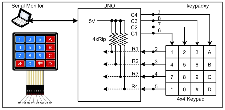

The servo motor is just pulsing and not moving and the 789C row of the 4x4 keypad does not work
We tried changing the servo and the keypad.
Thank you

Which Arduino board are you using and which pins of the Arduino do you have the LCD connected to ?
Try the test sketch you used to familiarize yourself with servos and the test sketch you used to familiarize yourself with keypads.
If you don't have two sketches (three actually, the LCD clu,d use one, too) like that, write them.
Test your wiring and your hardware.
Divide and conquer.
How are you providing power to the servo?
a7
Post an annotated schematic showing exactly how you have this wired, be sure to include all power sources.
in loop(), the default always appends to inputCode. But what if the keypad wasn't pressed? don't you need to check for NO_KEY and only process a return value when it is not NO_KEY?
Check your Keypad wiring as per Fig-1:
Figure-1:
