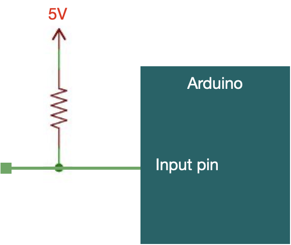

I don't have any resistors in my circuit. My understanding is that the matrix consists of switches, diodes and wires. Anything extra would belong to whatever this matrix is interfacing with. What is INPUT_PULLUP? I looked it up but didn't quite understand the explanation.

it's the state of an INPUT pin as if it was wired with an extra resistor and connection to 5V (this happens inside the MCU, and you configure that by software when you call pinMode(pinNb, INPUT_PULLUP);)
So that if you leave the pin floating
or if you connect it to 5V
then the input pin does see a HIGH
but if you connect it to GND
then the pin does read LOW. (the resistor is there to ensure there is no short circuit).
➜ this is called a pullup as the pin is "pulled up" by default but goes LOW if you connect it to low.
it's very often used with push buttons

Your matrix should not have pull-ups at all. The library uses the internal pull-up resistors.
I think that's OK as he said
the drawing he used assumes the columns would be made INPUT_PULLUP
but the library does not work that way. I think he got lucky making the mistake :slight_smile:
I'm no hardware expert and wonder what potential is read by the pin (at the red dot) in those 2 situations (diode facing towards or opposed to a closed switch connected to ground)
my crude understanding is that in the top case the current from the pullup can flow to GND through the resistor and diode and the pins sees a LOW whereas in the bottom case the diode prevents the current from flowing, so it's like the switch is open and the pin sees a HIGH
➜ that's why I was tempted to say that if the row is made an INPUT_PULLUP and the library pulls to LOW the columns in turn (as in the code of the library does), then the diode must allow the current to go through the switch and so the top drawing is what you want with the library.
happy to be proved wrong though, I'm a software guy...
