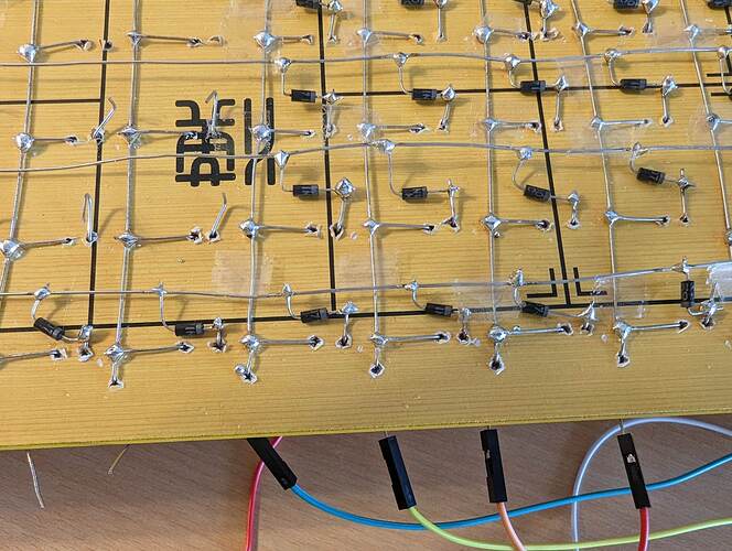

Keypad matrix last row and column of keys return the wrong data
Hi, I built a 9 by 9 matrix and I used these codes to run the circuit. These were contributed by community members.
Sketch:

const byte ROWS = 5; //four rows
// THE ROW NEED TO BE ON THE SIDE OF DIODE. MAKE SURE THE COLUMN PINS ARE THE SIDE OF THE MATRIX WIRES WITH DIODES
const byte COLS = 9; //four columns
uint16_t testArray[ROWS][COLS];
uint16_t hexaKeys[ROWS][COLS];
byte rowPins[ROWS] = {2,3,4,5,6};
byte colPins[COLS] = {14,15,16,17,18,19,20,21,22};
//initialize an instance of class NewKeypad
BigKeypad customKeypad = BigKeypad( makeIntKeymap(hexaKeys), rowPins, colPins, ROWS, COLS);
  for (int i = 0; i < ROWS; i++) {
    for (int j = 0; j < COLS; j++) {
      hexaKeys[i][j] = gobanLegend2[i][j];

When I connect my nine by nine matrix to arduino, the 9th row and column always give extra data, as if the edge case is not handled. Can someone help me with this?

Is row "IA" (letter #9+A) intentionally not present in the second array?
On a side note, a lot of the keypad matrix circuit diagram have the diode pointing towards the row wire and away from the switch, like this:
However, when I constructed my matrix, I swapped the diode direction by accident. So now it's pointing towards switch. Is that going to cause issues?
It is but it can really be anything :sweat_smile:
Cool let me try this.
I'm using the mega model now. I was using uno before.
My bad I didn't paste the code for 9 by 9 matrix, but the same thing happen for the 9 by 5 matrix. However, when I only use 2 by 2 matrix I didn't have the same issue.
Do you mind explaining why the array has to be initialized?
Why is this more future proof?
That array is the list of key values, like "gobanLegend[]". If you don't initialize it, all of the keys will have the value zero (which is not a valid key value).
I use a nested for loop in setup() to assign the 2d array's content. Is that not enough?
      //      Serial.print(hexaKeys[i][j]);
since your keypad is only 9x5, why don't you use the standard keypad library?
Yes, that will work. I didn't see that and setup() doesn't happen until after the BigKeypad object is created but since BigKeypad only keeps a pointer to the array it is ok to fill the array after the object is created.
Awesome that's great to hear. Thanks for confirming it. It is more convenient if I can define the hexaKeys dynamically.
