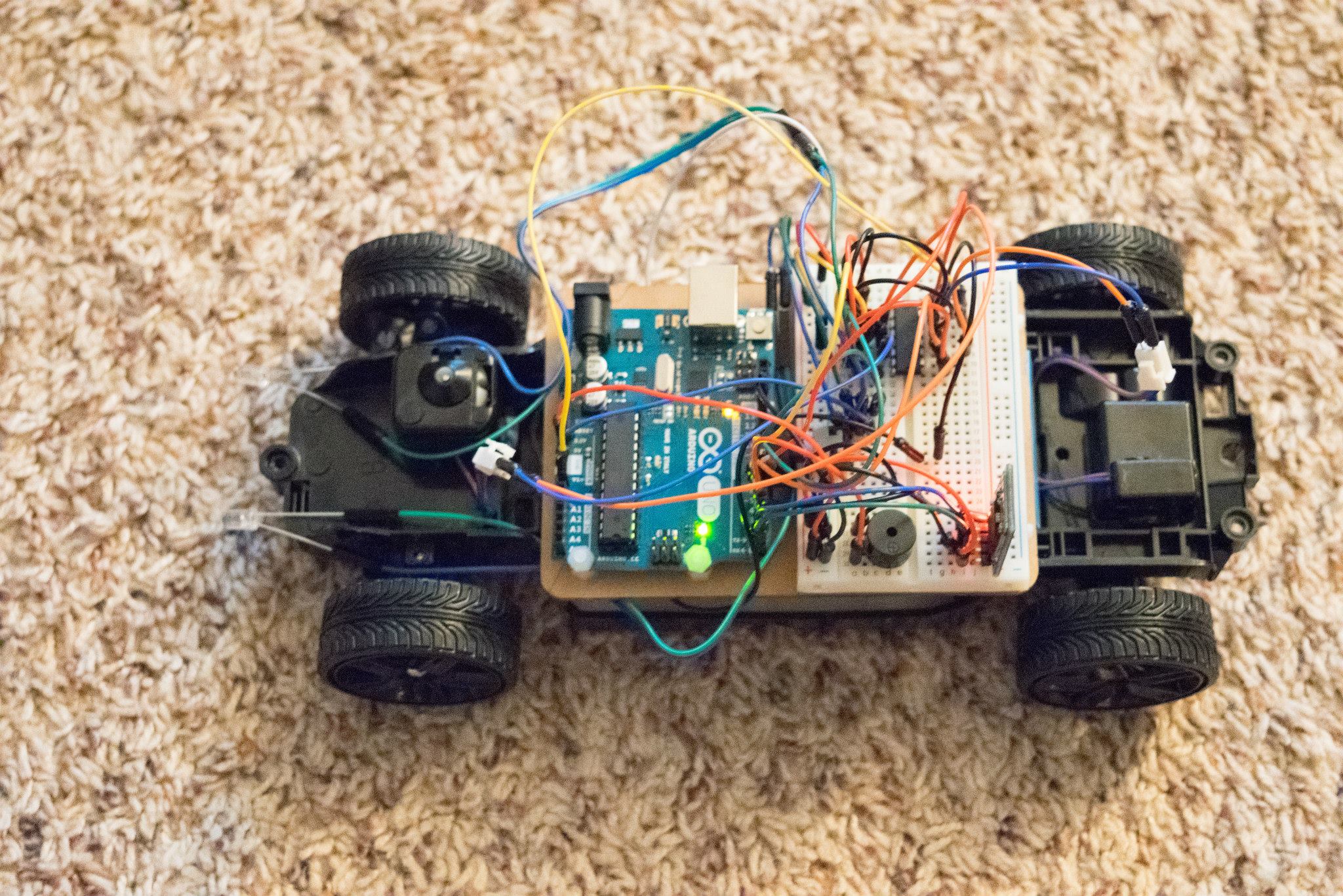

Hello there,
I hope you all doing well and had chance to rest and work on your projects during holidays.
I finally got Arduino kit with few shields and sensors last week and started learning. I got to the point where I have to combine two codes in order to get something that to my understanding is still complex. Right now I am stuck and I hope someone can help me get through this obstacle.
Let me explain first what the project is about. My son who is 15 months old has little ride on car with Remote control. I would like to use Arduino with blue tooth and motor shield to control it instead using remote control that came with car. I added LED lights, and extra bateries so it can run up to 5h at this point.
Now before I take on project that size in terms of voltage/amperage, I wanted to learn how to do it on small RC car. I have purchased Wireless Bluetooth RF Transceiver Module serial RS232 TTL HC-06 for Arduino, and have couple of L293D H drivers. Following the schematic and using the code from site http://www.ardumotive.com/arduino-car
I managed to build this little car on Picture 3 which is working fine for now using Android app from previously mentioned site, and even app from google play store: https://play.google.com/store/apps/details?id=braulio.calle.bluetoothRCcontroller
Now, what I am trying to do is to replace all these wires including L293d Driver on Half-Size Breadboard with nice Adafruit Motor Shield for Arduino v2. This is the newer version from the Adafruit site: Adafruit Motor/Stepper/Servo Shield for Arduino v2 Kit [v2.3] : ID 1438 : $19.95 : Adafruit Industries, Unique & fun DIY electronics and kits
My challenge is to understand how should I modify the code in order to use this shield without losing ability to control the car using same apps via Bluetooth? I am in process of learning Arduino programming, but I think I am still miles away to understand how to resolve this issue. Could anyone point me in right direction?
Once I conquer this part, I probably will need help with choosing proper H-bridge shield for the Ride On RC car that runs on 12V 14AH battery system. The H Bridge for the big RC Ride On Car will need to be able to handle 3 motors, two for the movement and one for direction. I will truly appreciate any suggestion.
Thank you in Advance,
Slavisha

NEXT please choose a style when coding. This code has at least three (3) styles.
I cleaned up part of the code to make it more readable.
== Breaking up the Code ==
The code can be broken into several sections. You should decide how.
However, there are natural breaks:
  • Turn, Forward, Backward, etc.
  • Speed
  • Lights
  • Horn
  • Voltage (battery level)
There other things that is pure logic is the 'state'. This appears to be the way the code is keeping the finite state machine. That is, the variable 'state' is an important variable and you should consider it for your design.
Let me know if this helps.
Jesse
