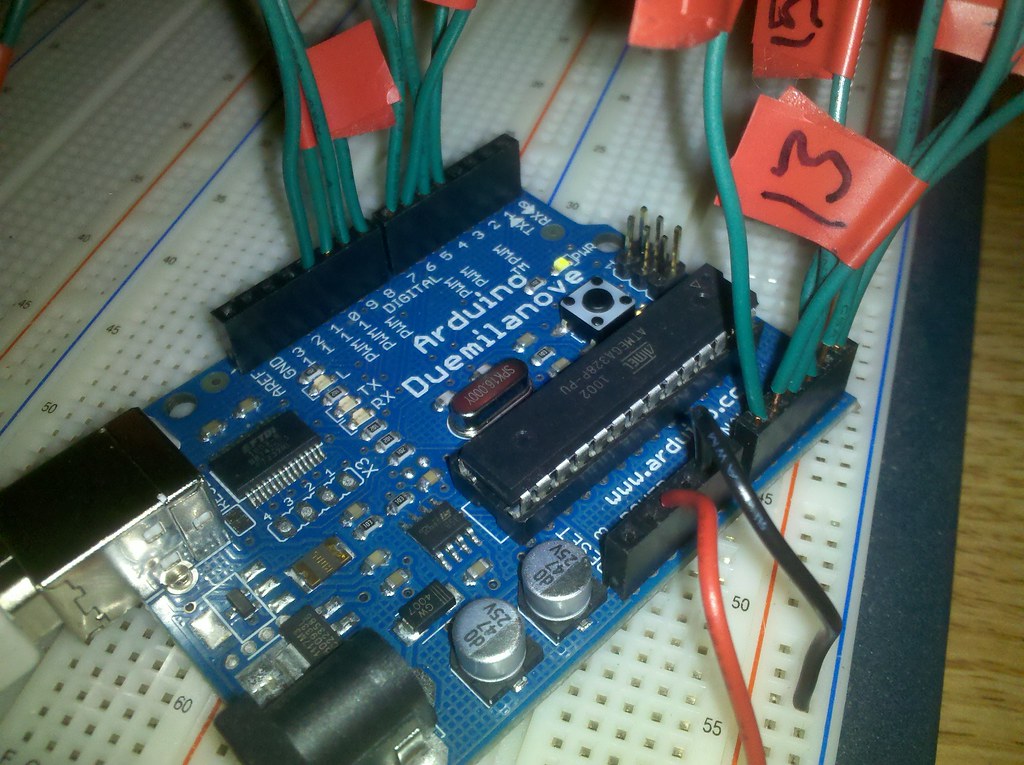

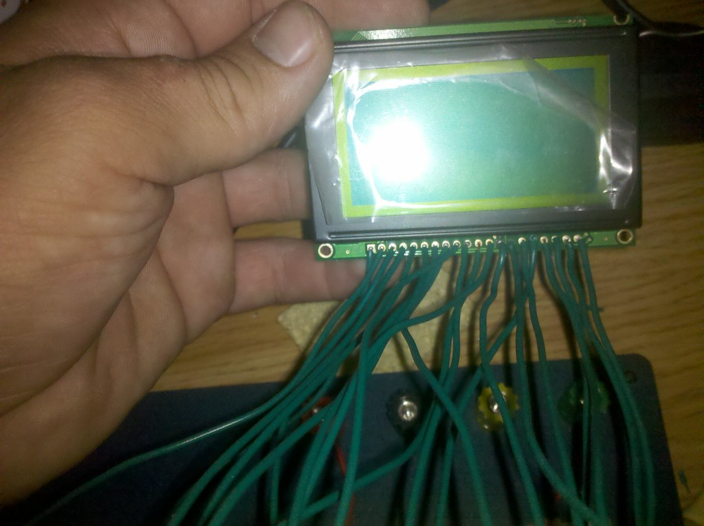

I am trying to find out why my LCD is not displaying anything.
I have downloaded the new Beta Files that include the diagnosics and have tried a few sample programs but i have gotten nowhere.
If you would like i can post the code to the GLCDdiags sketch, i chose not to include it at the moment because it is a massively long sketch.
I can post the Serial output of the diagnostics:
Serial initialized
GLCD Lib Configuration: glcd ver: 3 glcd_Device ver: 1 gText ver: 1
Panel Configuration:ks0108
Pin Configuration:ks0108-Arduino
GLCD:ks0108 DisplayWidth:128 DisplayHeight:64
Chips:2 ChipWidth:64 ChipHeight:64
 CSEL1:14(PIN_C0) CSEL2:15(PIN_C1)
 RW:16(PIN_C2) DI:17(PIN_C3) EN:18(PIN_C4)
 D0:8(PIN_B0) D1:9(PIN_B1) D2:10(PIN_B2) D3:11(PIN_B3)
 D4:4(PIN_D4) D5:5(PIN_D5) D6:6(PIN_D6) D7:7(PIN_D7)
Delays: tDDR:320 tAS:140 tDSW:200 tWH:450 tWL:450
ChipSelects: CHIP0:(14,0x1, 15,0x0) CHIP1:(14,0x0, 15,0x1)
Data mode:
 d0-d3:nibble mode-Non-Atomic
 d4-d7:nibble mode-Non-Atomic
Diag Loop: 1
Initializing GLCD
I uploaded this code to an arduino with the LCD connected and to one without one connected and they come out with the same information.
With the LCD connected the serial monitor get to Initializating GLCD.
So i know something is wrong.
I have connected everything just as it is put out by the serial monitor but its still stuck.
Ok rechecked wiring again and its right.
Now i just hooked up an Oscope to the data out pins and im not getting an output.
on the CS pins i get a quick blip but nothing else. Im thinking the sketch is hanging up somewhere.
Im going to post it here in the next post.
I have the contrast set, backlight is on.
other then that i have nothing.
If you guys could help point me in the right direction, i would so grateful.
Thanks
-Erik

Here is some pics and some other code albeit not the diag code i was talking about earlier:

Your wires are all green and you didn't show the entire picture, just the screen, and then separately the arduino. You need to put them on the same picture so someone can figure out which wire is going between which arduino pin and which LCD pin.
Do you have a breadboard and some headers instead of green wires?
