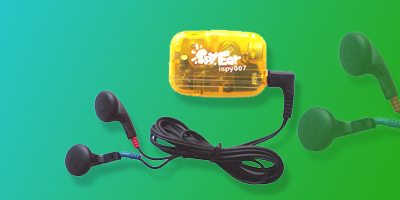

If you are looking at audio reproduction, try discrete components. Back in the day, every novice made a "big ear" (giant-ear, spy-ear...) which accurately amplified sound (not just noise, but voice, music, et c.)... and that 160-in-one with spring-connections brings back memories.
After reading the linked spy ear article, just to clarify, because it is very possible that im understanding you wrong, are you telling I should be using an audio amplifier? Because if so, the MAX9814 does have a preamp known as the Maxim MAX9814, as mentioned in the Adafruit description.
