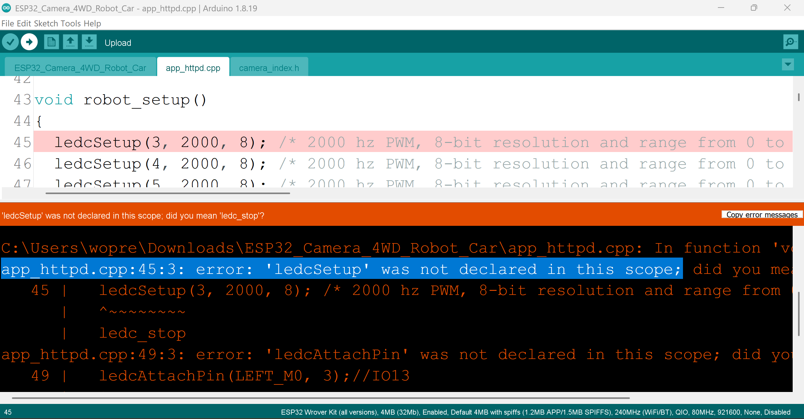

LAFVIN ESP32_Camera_4WD_Robot_Car error
I want to buy this robot kit from LAFVIN, they provide everything on their website including the demo code.
I downloaded the code and compiled it and got this error, I don’t know how to fix it.
I think the functions causing the error are in the esp32 source code folder, I searched their with notepad++, and didn’t find the definition of those functions.

  1. The error:

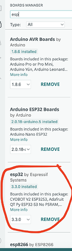

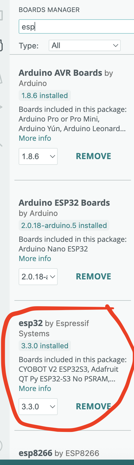

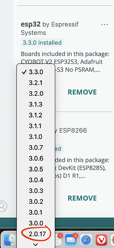

There are breaking changes in the esp32 code. ledc.... is affected, roll the espressif esp32 boards back to 2.0.17.
My friend :slight_smile: Thank you so much,
