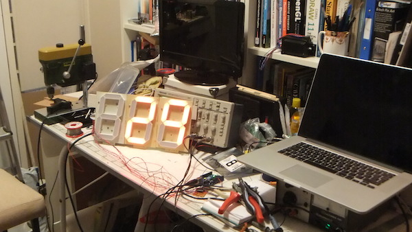

These are large displays that have several LEDs in each segment in series, so you need 12V to drive them.
Like these I used one time:-
Ahh... I see.. so not just larger in SIZE .. but also more LEDS.
@Grupy_Mike
Did you buy those or make those? They look nice (well diffused too) from the pic!
These were bought, but bought for me so I haven't got the link, sorry. It was for this project:-
For scale those are people at the bottom
