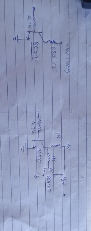

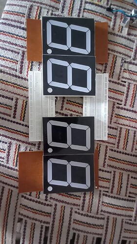

Hi guys, this is my second post here. I need some help to multiplex these 4-inch seven segment display to create a gps clock using arudino uno
From the knowledge I gathered, to display the time on the large seven segments i need driver and a switching circuit to display the relevant time. After testing i found it needs 9V 40ma to drive it.
This is the circuit i am reffering . Now i am getting a bit confused on how to multiplex the display through transistors like bd140 and bc547 and the deadline is tommorow.

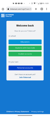

All I get (using the fixed link provided by @JohnLincoln) is
Can you post the schematic here on the forum please?

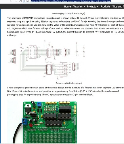

High-voltage seven segment LED display driver with SPI interface | Embedded Lab

Large 7-segment displays are best driven by a shift register chip of the TPIC family.
Sparkfun has a board for that.

These are 4-inch common anode displays and i do not plan to use decimal point

I assume you have those large displays because you want to see them from far away, and maybe in bright light. If so, then forget about matrixing. If you matrix four digits, then each digit is lit up 1/4 of the time, which is roughly half the percieved brightnes a digit could be.
If you want performance, then use four TPIC6B595 chips (or a member of that TPIC family).

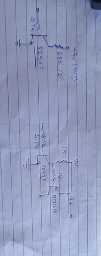

I have two options, one is shift register and other is creating a driver and switching circuit using transistors like this
Which one should i follow ?

I still cannot see your Tinkercad diagram, please post an image of it here on the forum.
For your hand-drawn schematic of the anode and cathode drivers, the anode driver looks ok but the cathode driver makes no sense, I guess that is an error. Where does the display cathode connect to the circuit, and why is the npn collector connected by a resistor to 5V?
