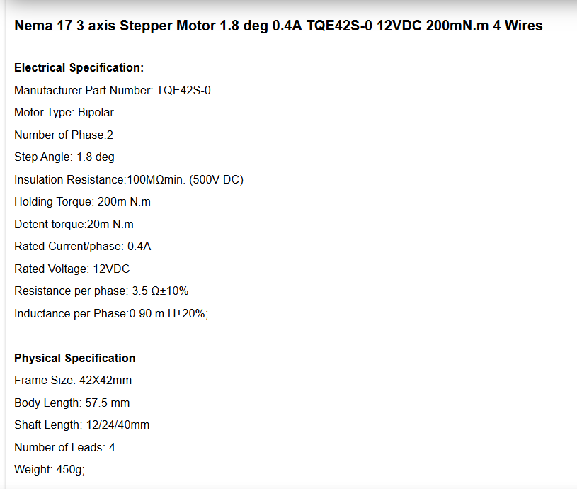

One key component is the stepper motor; Since I'm wanting second, minute, and hour clock hands, I either need a special motor or some complex design with multiple motors. Fortunately I have found a TQE42S-0 NEMA 17 stepper motor which has 3 nested drive shafts and I believe with the right wiring would be excellent for this project.

Please post a link to the datasheet for that stepper. NEMA 17 tells nothing interesting.
I was unable to find a proper datasheet for this motor but this page should contain most of the details:
That is an interesting stepper, and a reasonable choice for your clock.
The simplest method of homing a stepper is to send enough pulses to run the shaft into an end stop, which will not damage the motor.
For a clock, you could use a solenoid to extend a pin out of the clock face, at for example the 12:00 position, to act as the end stop for all three hands. Retract the pin after the homing operation.
With the 1.8 degree step size that is 200 steps per revolution. This does not match up well with the 60 steps you need for seconds and minutes.

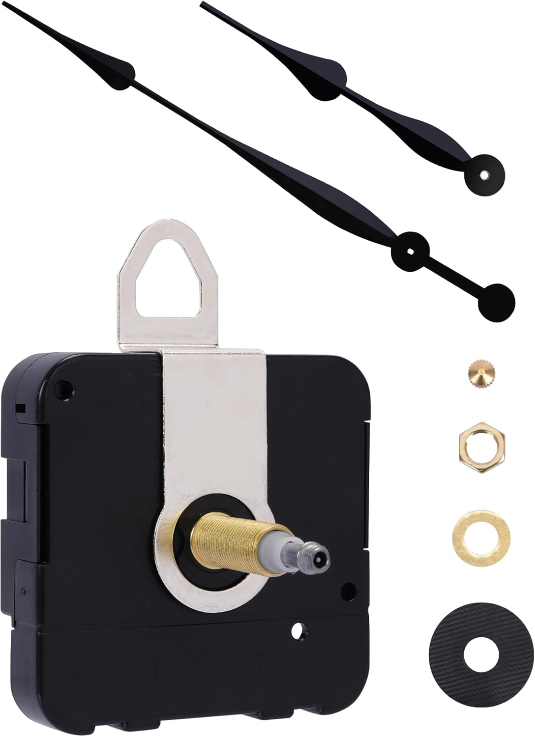

Amazon has kits. Make the face as large as you want. I made a 1m face with balsa arms and this movement. One battery per year.
