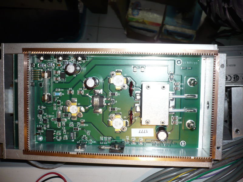

I opened the machine, and I get really surprised when I saw the laser it have! Aparently, looks to be a CO2 laser air cooled... Only I have to understand how I can PWM drive the power supply and here we go! So I desarmed the power supply and I get rally surprised to see the quality of the electonics and these high frequency mosfets! Woooow! Why this technology?... I started to documente myself about this and I conclued this laser isn't a CO2 laser but a ARGON LASER!

The laser power supply pictures:

Here is the input to the "laser tube":

So my firt question is : What type of laser is it?

It's an RF-excited CO2-laser. 10.6~~nm~~um - not Argon-Ion!

Zapro: It's an RF-excited CO2-laser. 10.6nm - not Argon-Ion!
// Per.
You mean 10.6 um. 10.6 nm is xray.
ChrisTenone: You mean 10.6 um. 10.6 nm is xray.
Yes. Typo.
