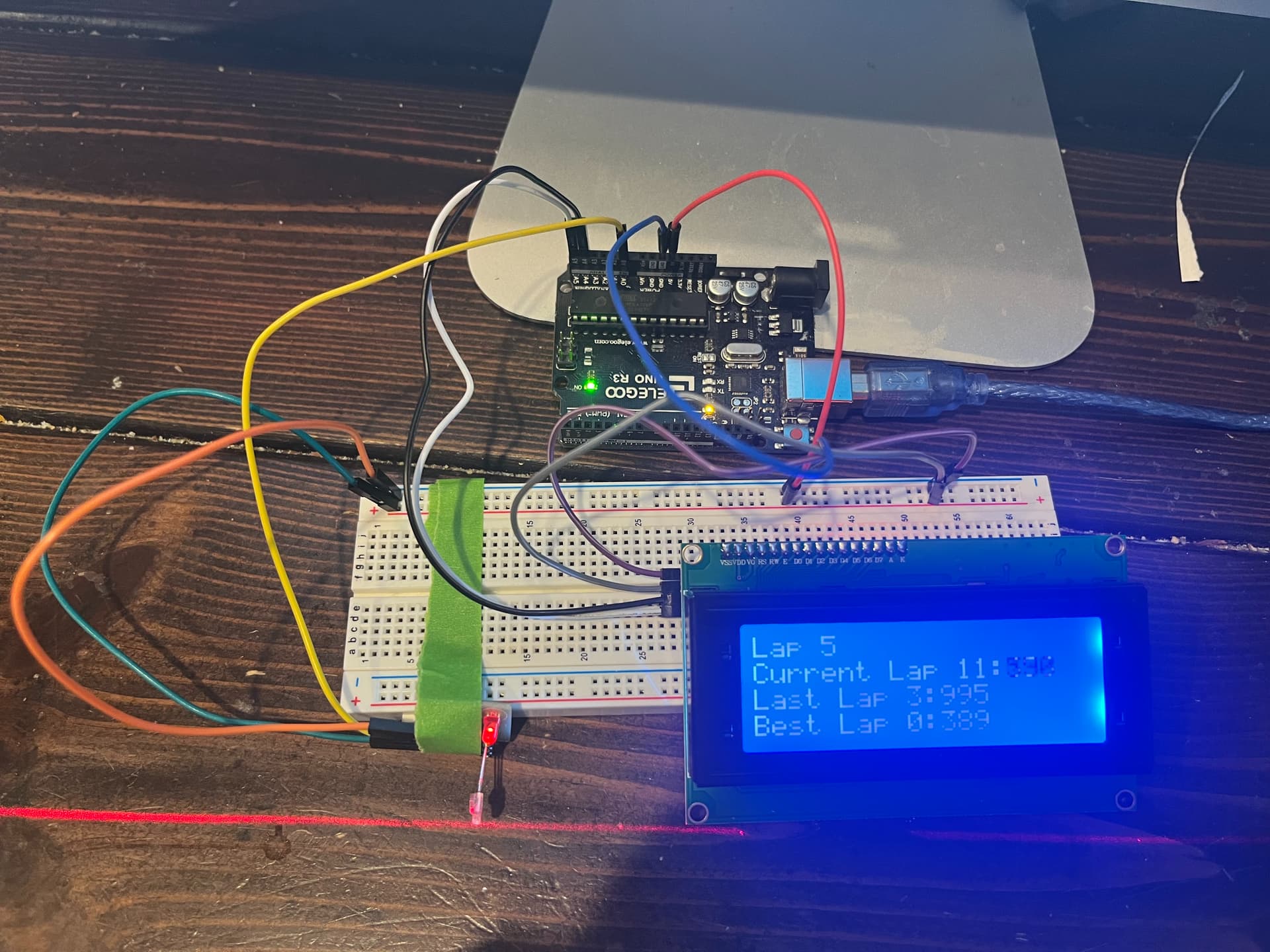

Hello, I'm very new to arduino and coding. It's a miracle I've gotten this project this far. I wanted to create a simple laser lap timer for my backyard pumptrack. I'm pretty sure I have the code doing what I want. Count laps, record current lap time in seconds and milliseconds, show last lap time, show best lap time. However, while testing I realized that if the laser beam is broken by walking through it, the first leg crossing it breaks the beam (LOW), then the space in between the legs allows the beam to hit the sensor (HIGH), then the second leg breaks the beam again (LOW). I need to program in some sort of delay in my coding, so that when the front bike wheel breaks the beam, the back bike wheel doesn't stop the timer. I'm assuming this is very easy, but I'm having trouble understanding what to put and where to put it in my code.
Here is my code

Adjust the code to ignore any beam breaks during the lockout period. You can modify your code like this.

Nice.
I need a wiring diagram. I'm not good enough to figure where everything goes yet.
The wiring is the same as your wiring... but here is a way to simulate your project in a "wired-up" model...
  1. Go to WOKWI.COM...
  2. Click on Arduino (Uno, Nano, et c.)
  3. Scroll a few lines down and click on NANO
  4. On the left, in the "sketch.ino" tab, copy/paste this into "sketch.ino":

  *milli_val = value - *sec_val * 1000;
  1. To the right of the "sketch.ino" tab is "diagram.json" tab... copy/paste this into "diagram.json" tab
  "version": 1,
  "author": "Anonymous maker",
  "editor": "wokwi",
  "parts": [
      "type": "wokwi-arduino-nano",
      "id": "nano",
      "top": 51,
      "left": -75.3,
      "rotate": 90,
      "attrs": {}
      "type": "wokwi-lcd2004",
      "id": "lcd1",
      "top": -185.6,
      "left": -23.2,
      "attrs": { "pins": "i2c" }
    { "type": "wokwi-vcc", "id": "vcc1", "top": -191.24, "left": -48, "attrs": {} },
    { "type": "wokwi-gnd", "id": "gnd1", "top": -115.2, "left": -58.2, "attrs": {} },
      "type": "wokwi-pushbutton",
      "id": "btn1",
      "top": 57.5,
      "left": -140.5,
      "rotate": 90,
      "attrs": { "color": "green" }
      "type": "wokwi-resistor",
      "id": "r1",
      "top": 81.6,
      "left": -86.95,
      "rotate": 90,
      "attrs": { "value": "10000" }
  "connections": [
    [ "lcd1:SCL", "nano:A5", "green", [ "h-19.2", "v221.1" ] ],
    [ "lcd1:SDA", "nano:A4", "green", [ "h-9.6", "v192.2" ] ],
    [ "gnd1:GND", "lcd1:GND", "black", [ "v-38.4", "h28.8" ] ],
    [ "vcc1:VCC", "lcd1:VCC", "red", [ "v0" ] ],
    [ "nano:A0", "r1:1", "green", [ "h0" ] ],
    [ "r1:1", "btn1:1.l", "green", [ "h0", "v-9.6" ] ],
    [ "nano:5V", "btn1:2.r", "red", [ "h0" ] ],
    [ "nano:GND.1", "r1:2", "black", [ "h0" ] ]
  "dependencies": {}
  1. Click the white arrow in the green circle to "run" the simulation
  2. Use the green button as the LASER beam to "start" and "lap"
Thanks, that works. I did come up with another solution after I posted this using "delay(1000);" inserted after the code counts the current lap. Just curious if doing it that way is worse/better. Ether way, it's working and I'm pretty happy about it.
