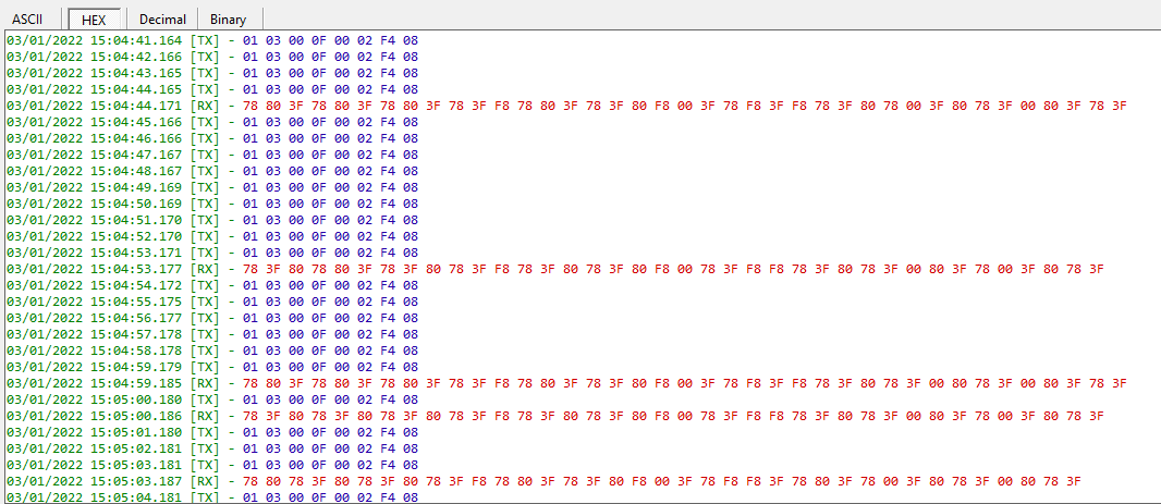

hello everyone, am working with the laser sensor tw10sp to mesure distance and interfacing it with UART. It require commands to work. i send the HEX command via UART and it response always with the same HEX number (clearly something wrong).
Any help please !!
Did you forget something?
the command of distance mesurement sent to the sensor is 100% correct, but always it response with HEX values showed in the picture below ; which i can't understand
Perhaps there's a problem with the code you didn't post.

Use 9600 in the baud rate configuration.

Because you have no object of type SoftwareSerial called myserial declared in global scope.
