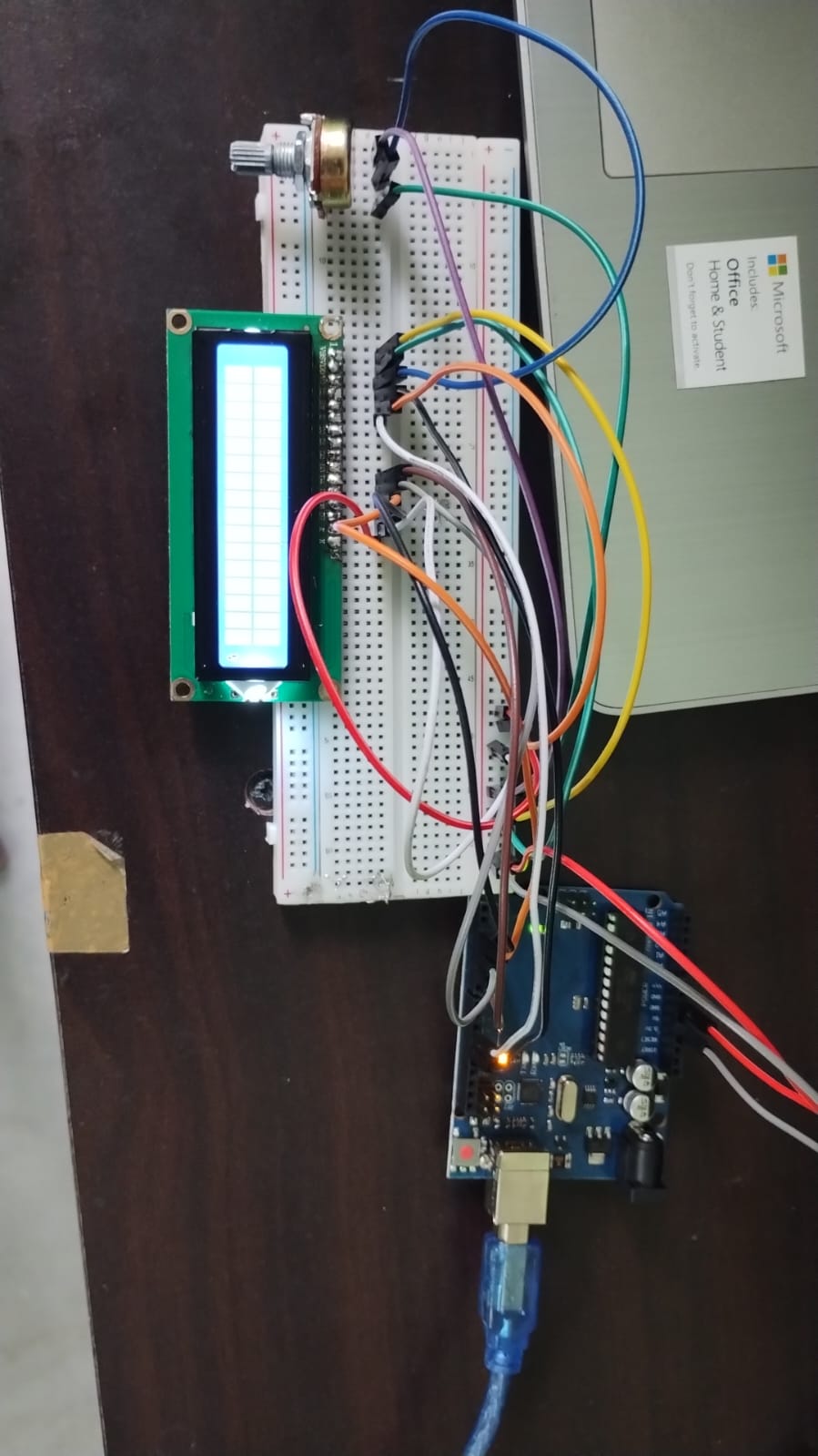

Hey everyone, myself Pranav, an Arduino beginner. I was working with an 1602 LCD screen. I had soldered it all by myself (no experience in professional soldering) and the pins were a little up and down when I soldered it. So I had done some mess and somehow removed the solder and fixed it and then soldered it again and when I made the circuit and put the Arduino, it showed white squares. While plugged into the circuit, I did some soldering stuff and it didn't work. When I put all the pins as it is from the code that I had written into another code from google, it showed me an error that semi colon was missing. so when I fixed it in my main code, it worked. But now it's been 2-3 months and when I again made the circuit the lcd screen shows white squares only. I did some soldering stuff again while using the code from google (the one that i used last time) but that showed me some random characters on the screen. Even I tried using the code that I had written and used it last time which was working fine with the lcd. Help is appreciated. And below ive attached the video when the lcd screen was working.
I tried rechanging the circuits but that ain't helping
(here is the link to the video when the lcd was working)
[Video when LCD was Working] (https://drive.google.com/file/d/12tn2InCSlExx4qXRaUtUhaJ4-ye4F3VH/view?usp=sharing)
I know that the soldering is bad, but it was like this only the last time also

Not to discourage you, but
This is bad. To do work on a live circuit is begging for problems. Since you done it and other measures, the question is how can you know the display is ok?
Ok Thanks but it still not working
Could you show a good resolution still picture of your circuit so we can see things like if the breadboard has split power rails etc.
If the code (both sketches) worked OK last time, they'll work this time.
If you've rebuilt the circuit on that breadboard, then a wiring error is a likely cause.
Yes, I've rebuilt the circuit on that breadboard like 10-15 times, even doing it without a potentiometer also
No picture , then it must be the GREEN wire.

Does you protoboard have power bus breaks like this along its edges?
@bitmystic - Do you understand the first sentence can mean "you probably broke it." If it worked, then you "fixed it" then it did not work, you broke it. You can verify this by using the LCD on a working LCD circuit.
yes it has a protoboard
Here is the image.
IDK why but it started to work after I built the circuit just now. But anyways I wanna know why this problem is occuring frequently
Handling.
Perfect. So the main problem has been resolved so you can mark your last post as a solution. For the future, when you supply an image or picture, ensure the quality/resolution is good enough to show problems like bridged solder joints etc. Breadboard are inherently unstable and will always give problems, forcing you to remake connections etc. Correctly soldered connections are better.
