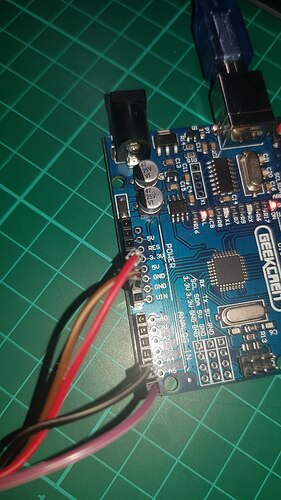

I started to learn Arduino and make my projects a several weeks ago and finally I have some hardware arrived and did some test. I bought this display with i2c interface:
I download library LiquidCrystal_I2C GitHub - johnrickman/LiquidCrystal_I2C: LiquidCrystal Arduino library for the DFRobot I2C LCD displays and did upload examples to my Arduino Uno and change the code for correct address, which i check
Now i have just one row blocks on the screen and not the letters. Can you advise me, what I doing wrong.
here are the pictures : https://photos.app.goo.gl/CnbTFpNBTqVPWApT9
Hi, please post your code and pictures here on the forum, as explained in the forum guide.
This picture is not very helpful by itself.

Have you soldered the i2c PCB to the LCD? Just pushing it on will not work.
OK, you have power but no communication with the backpack.

Soldering does look ultra-dodgy, in fact despite the backlight working, the last three pins appear not to be connected at all!
You are absolutely correct Paul_B !! thank you so much. The problem was the soldering. I start to practice, just 2-3 weeks ago. But when i did re-soldering of all pins - everything start to work just fine.
