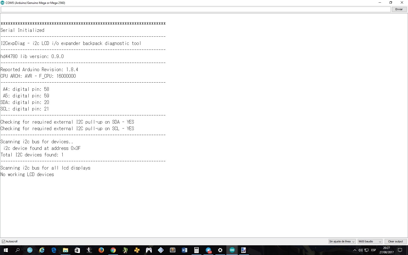

Well, I have downloaded and tried with bill's library (I didn't know it, it's awesome), but I got the same, also I've tried with the I2CexpDiag example that library has, it's says its all ok, except for one thing... It said that there are no working LCD Devices, so i assume that my 20x4 LCD is not working at all...

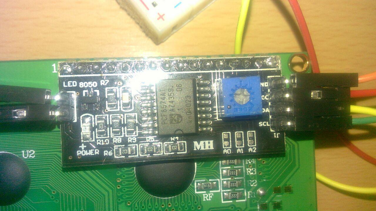

Can you post the serial output from the diag sketch so I can take a look?
Along with a photo of the actual backpack.

BTW, this type of issue has typically been an issue with solder connections, either the backpack to the LCD or the backpack parts themselves, or in some cases the actual PCF chip.
I'm seeing more of these wierd issues, so I'll probably add some additional code to the diag sketch to try to help.

This is the LCD:
This the I2C Backpack:
And this the serial output:

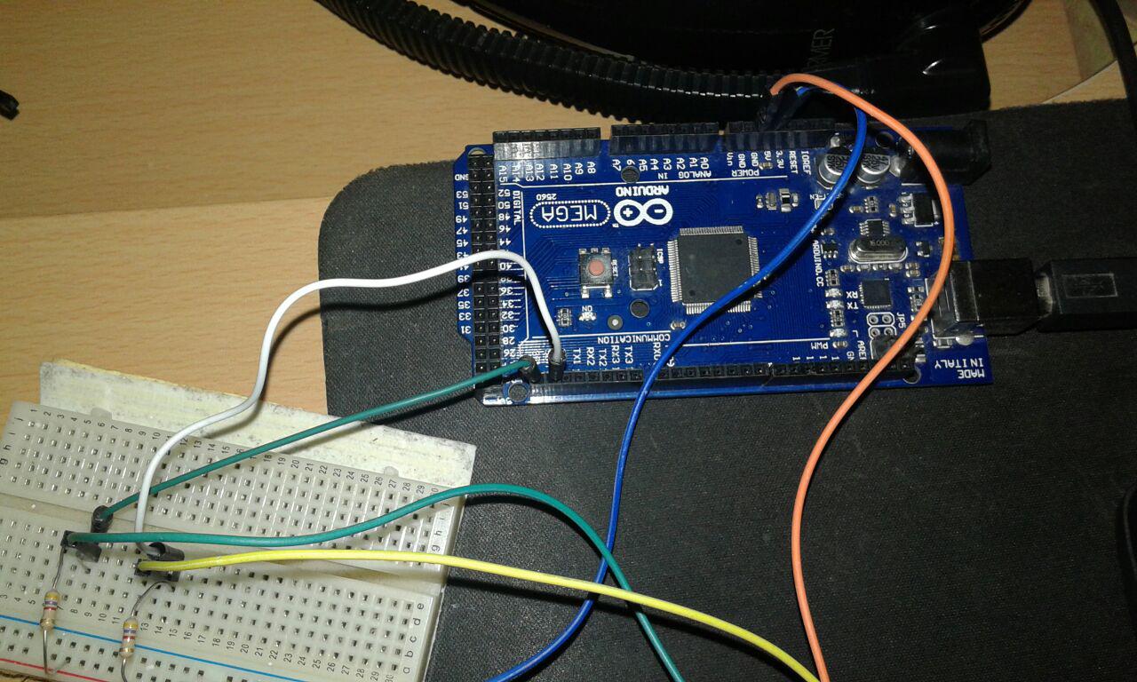

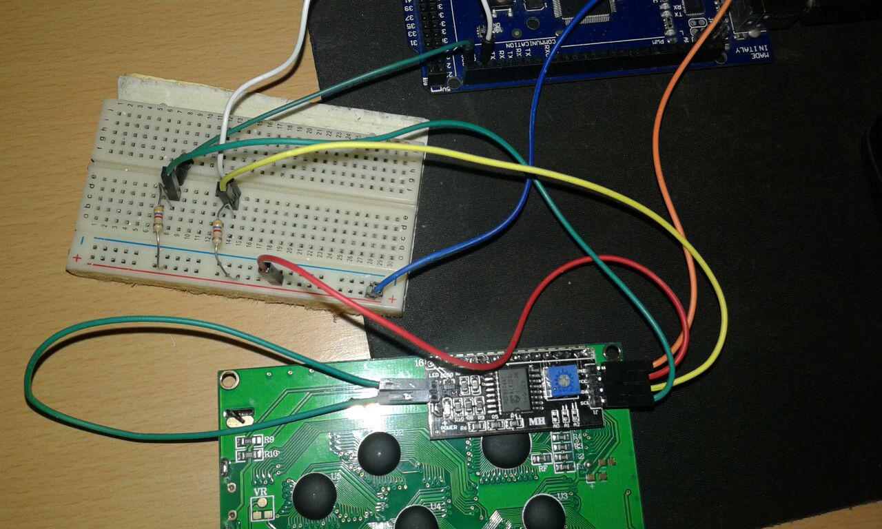

Are you using the breadboard?
How are you wiring the backpack to the Arduino?
What is the error code (how many blinks) that is showing up on the HelloWorld?
Yes i'm using a breadboard, I plug SDA and SCL to pins 20 and 21 of the Arduino MEGA, both with a 4k7 pull up resistor, and well, Vcc to 5v and GND to GND. I use a Female-female wire to the Backlight pins.
The HelloWorld does 1 blink every 2 seconds approximately.
Edit: Just added a few pics of the connection. Also, i've checked all the wires i'm using, and all of them seems to have continuity.
The external resistors on the breadboard are not needed; I would eliminate them. It will also make the wiring easier.
The backpack that you have has them on it. R8 and R9
Also, mega 2560 boards usually have them on the Arduino board.
If you are curious, you can use the diag tool to test if you have pullups on the arduino by disconnecting all the wires to the backpack/LCD/breadboard and running the diag tool.
It will tell you if detects pullups.
So when using your mega2560 board, with the resistors on the arduino board, you now have three 4.7k pullups on each i2c signal.
That reduces to around a 1.5k pullup which is pretty snappy and pushes the signal currents up near the i2c spec limits.
Try to see if works any better when you eliminate the external pullups - wire the SDA and SCL signals on the backpack directly to the mega header pins.
--- bill
