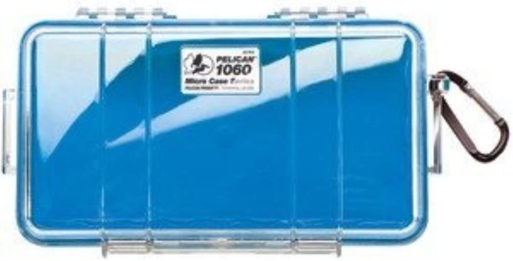

The pelican and candy boxes won't do it for me because I'm mounting into a flat panel. Thanks though.
I think the pelican box is way too expensive. I've thought about the Ferrero box but it's so breakable.
