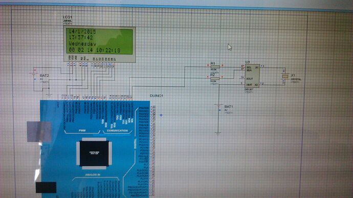

i am new here. so i am doing a project for my final year project, that counts days until certain date. i have managed to display the current day, date and time on the lcd. the problem is i dont have any idea how to display the countdown for the amount of days left.
i have found a page that does the exact same project as mine, but the difference is that it doesnt use any coding. here is the page Siliconfish: Arduino LCD Countdown Clock
the screen capture and my coding as enclosed. i really hope that you can help, thank you so much !! :-*

Just for the sheer hell of it, here's a stab (I haven't run it so you'll probably have some debugging to do)
typedef struct plainDT
  {int year;
   int month;
   int day;
   int hour;
   int minute;
   int second;
plainDT targetDate={2017, 12, 25, 0, 0, 0}; //Christmas day 2017
plainDT diff;
char diffString[21];
#include "RTClib.h"
#include <LiquidCrystal.h>
RTC_DS1307 RTC;
void setup () {
    Wire.begin();
    RTC.begin();
     lcd.begin(20, 4);
   pinMode(8,OUTPUT);
  if (! RTC.isrunning()) {
   Serial.println("RTC is NOT running!");
    // following line sets the RTC to the date & time this sketch was compiled
   RTC.adjust(DateTime(__DATE__, __TIME__));
void loop () {
    DateTime now = RTC.now();
    lcd.setCursor(0, 0);
    lcd.print("Digital Clock");
    lcd.setCursor(0, 1);
    lcd.print(now.day(), DEC);
    lcd.print('/');
    lcd.print(now.month(), DEC);
    lcd.print('/');
    lcd.print(now.year(), DEC);
    lcd.print(' ');
    lcd.setCursor(0, 2);
     if (now.hour()<10)
    lcd.print('0');
    lcd.print(now.hour(), DEC);
    lcd.print(':');
     if (now.minute()<10)
    lcd.print('0');
    lcd.print(now.minute(), DEC);
    lcd.print(':');
    if (now.second()<10)
    lcd.print('0');
    lcd.print(now.second(), DEC);
    lcd.setCursor(0, 3);
   int dayofweek = now.dayOfWeek();
   switch(dayofweek){
     case 1:
     lcd.print("Monday");
     case 2:
     lcd.print("Tuesday");
     case 3:
     lcd.print("Wednesday");
     case 4:
     lcd.print("Thursday");
     case 5:
     lcd.print("Friday");
     case 6:
     lcd.print("Saturday");
     case 0:
     lcd.print("Sunday");
calculate();
lcd.setCursor(0,0);
lcd.print(diffString);
void calculate()
DateTime now=RTC.now();
plainDT TARGET=targetDate;
plainDT NOW={now.year(),now.month(),now.day(),now.hour(),now.minute(),now.second()};
//makes maths easier if months are zero based
TARGET.month--;
NOW.month --;
int maxDays[]={31,28,31,30,31,30,31,31,30,31,30,31};
int dayCount=maxDays[NOW.month];
if ( (NOW.month==1)  &&  NOW.year==( (NOW.year/4) * 4) )
  dayCount=29;//works for any year within the next 3 centuries at least
diff.second = TARGET.second - NOW.second;
if (diff.second < 0)
   diff.second = 60 + diff.second;
   NOW.minute++;
diff.minute = TARGET.minute - NOW.minute;
if (diff.minute < 0)
   diff.minute = 60 + diff.minute;
   NOW.hour++;
diff.hour = TARGET.hour - NOW.hour;
if (diff.hour < 0)
   diff.hour = 24 + diff.hour;
   NOW.day++;
diff.day = TARGET.day - NOW.day;
if (diff.day < 0)
   diff.day = dayCount + diff.day;
   NOW.month++;
diff.month = TARGET.month - NOW.month;
if (diff.month < 0)
   diff.month = 12 + diff.month;
   NOW.year ++;
diff.year = TARGET.year - NOW.year;
if (diff.year < 0)
  diff=(plainDT){0,0,0,0,0,0};
sprintf(diffString,"%04d %02d %02d %02d:%02d:%02d",diff.year, diff.month, diff.day, diff.hour, diff.minute, diff.second);

the difficulty is i do not know how to set the target time, and make the program counts the amount of days left. do you understand me ?

hey there, i've tried compiling your coding, thank you so much for it. but i'm not quite sure though what's that on the last line. hope you can explain.

No I think this is the code she's trying to compile
Calculate days remaining
Position cursor
Output the value
Weedpharma
She doesn't know what the command "weedpharma" means. I suspect it's causing a syntax error :wink:
