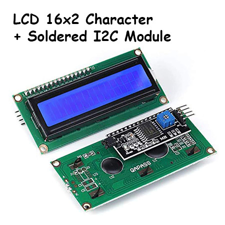

I do not have the exact page because it is quite old and their website is down, but I found identical product in this page

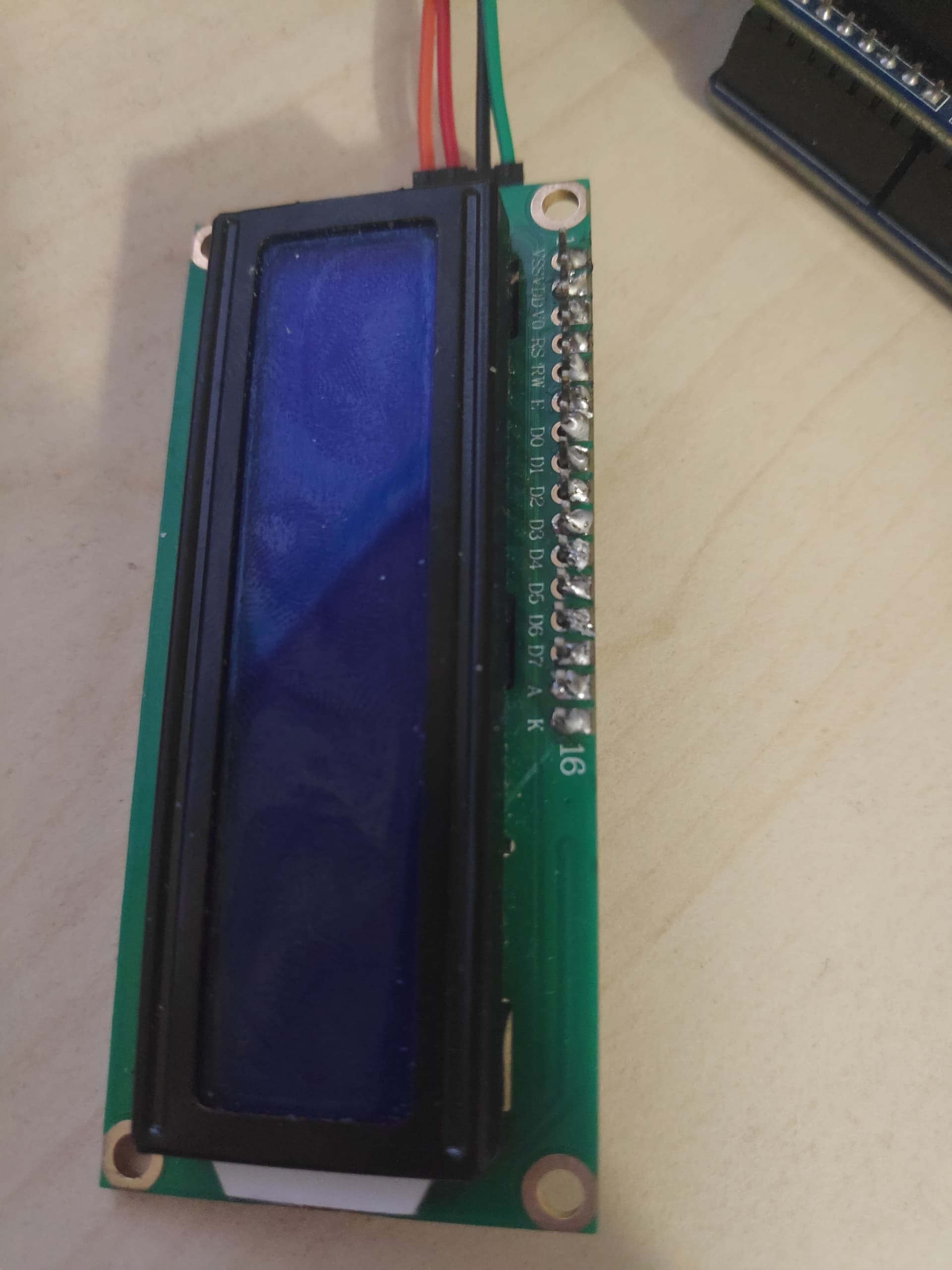

For the soldering I might post a photo, because this might be 2nd time I ever solder

Your picture is not clear enough.
Please show a clear picture so we can evaluate your solderings.
Take a look at the product page you have postet - they show a decent and consistent soldering.
The solder points should shine, solder should be on both side of the mounting hole.
E and D0 seem to be shorted on your picture.
Redo your soldering.
Soldering is bad on several pins. Use hot iron (650-700) and liquid flux.
Thanks guys, I resoldered it and it worked.
