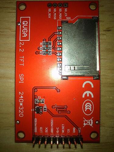

well, in mine there is a voltage regulator to get 3.3v from 5v power supply. But also there are a jumper to do a bridge from Vcc to 3.3v bus trace. In my case both supplies are correct. What is confusing in ebay shops is that they indicate 5 and 3.3v compatibility and one can imagine that it is the same for the serial interface pins, but really not...
Is it the same as this board? (And if so, I presume you refer to jumper J1? To clarify; must I supply 5v if the jumper is not present?)
Can you confirm if the IO's source or sink?

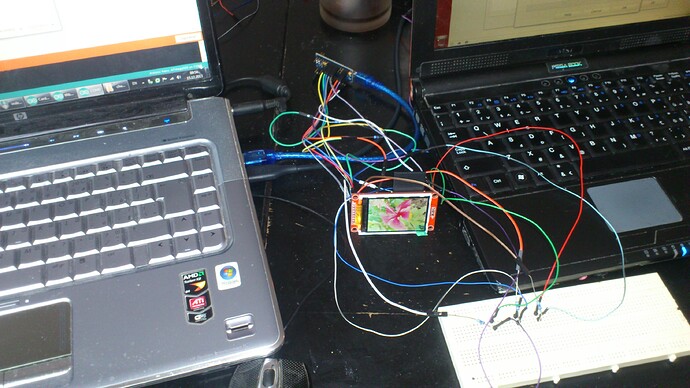

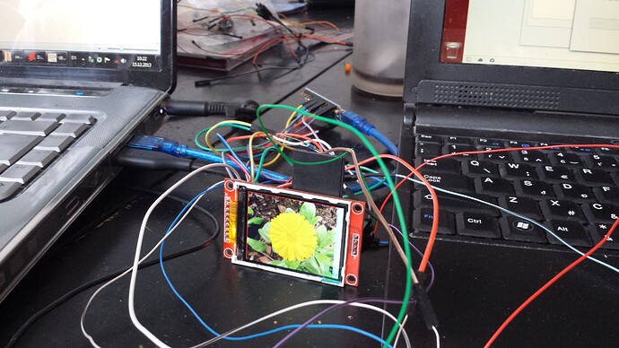

Yeah ,I got mine working too ! 8)
Hello world ! :smiley:
I´d like to tell everybody how I have done it, maybe it will help:
I had a arduino mini pro 5V, a 5 Channel voltage regulator 5V->3V and the Display, got it from somewhere really cheap with no documentation. I tried so much, but what gave me the start was this setup:

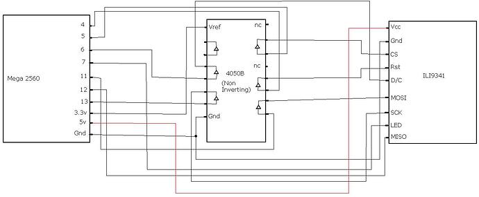

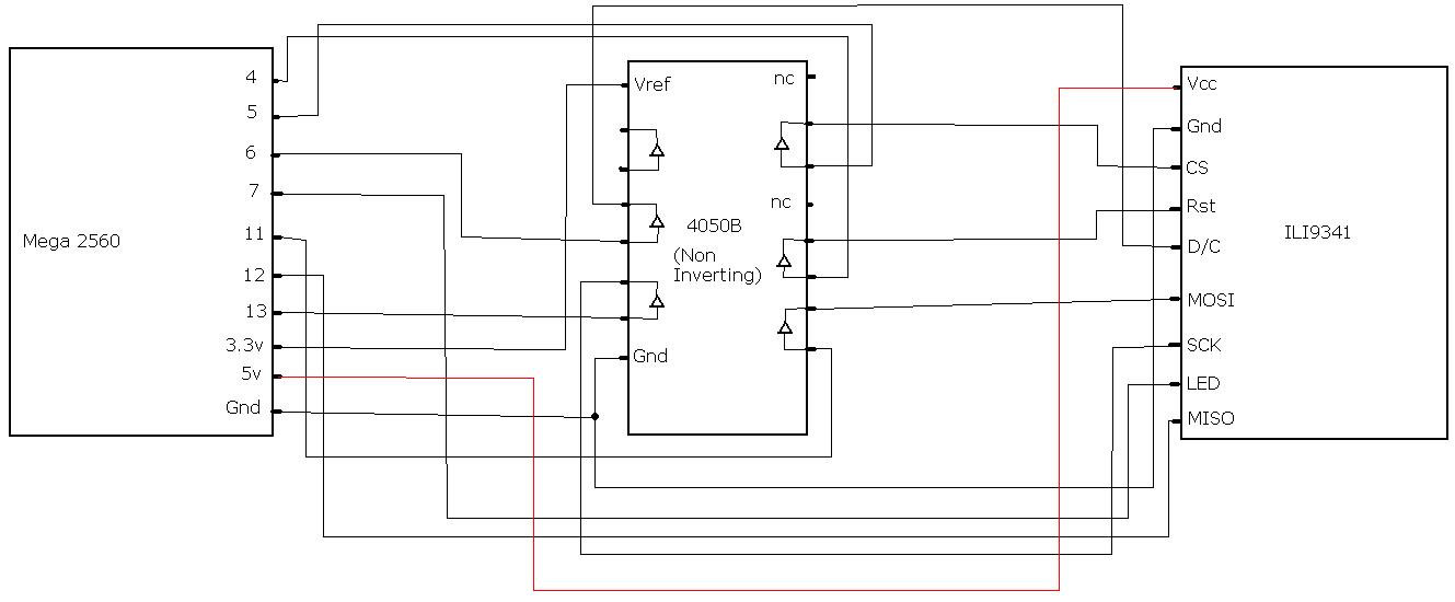

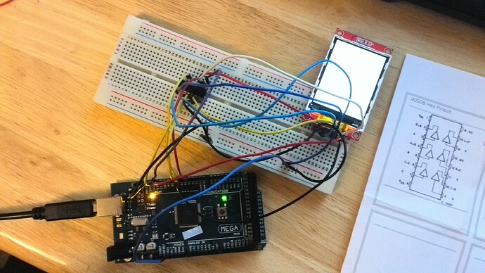

Right, I'm at my wits end with this. I'm starting to suspect that I may have a bum/blown up ILI9341 and would very much appreciate any help anyone can offer.
I'm now using nid69ita's ili9341.rar examples from reply #18. I'm just getting a white screen on any of them.
I have electrically tested and can confirm all outputs from my Mega 2560 and 4050B hex buffer are working and reaching the ILI9341 as expected.
I have tried two power connection methods, supplying 3.3V and 5V to Vcc on the ILI9341. The Mega 2560 is powered via my PC's USB.
Attached are diagrams of both power schematics I've tried and a photo of my setup. I apologise in advance for any damage they may cause to your eyes or psychology!
I think you are wrong about powering. I think you need to use 3.3V from Mega to ILI (as your schema) but also you must use 3.3V from Mega to CD4050.
I learned this watching this tutoria from Adafruit, about a LCD Nokia 5110 and a CD4050.
And the library in the rar file I think is wrong for macro about Mega pin definition as I written in previous post (about RST pin)
THe Vcc to the CD4050BE should be the 3V3 supply from the Mega and you 'should' put at least a 47uF cap across it... there's only a 1 uF MLM SMD capacitor (C14) on the Arduino board.. as the 3V3 'source apparently was only intended as a reference for changing the board from USB to DC IN Power the black PSU connector... BTW I've found that a 7.5V DC Switcher wall wart works with least heating under an 400 mA full load... Not great but 1/2 of the wasted heat of an equivalent 9V wall wart... .6 Vs 1.2 W heat produced
