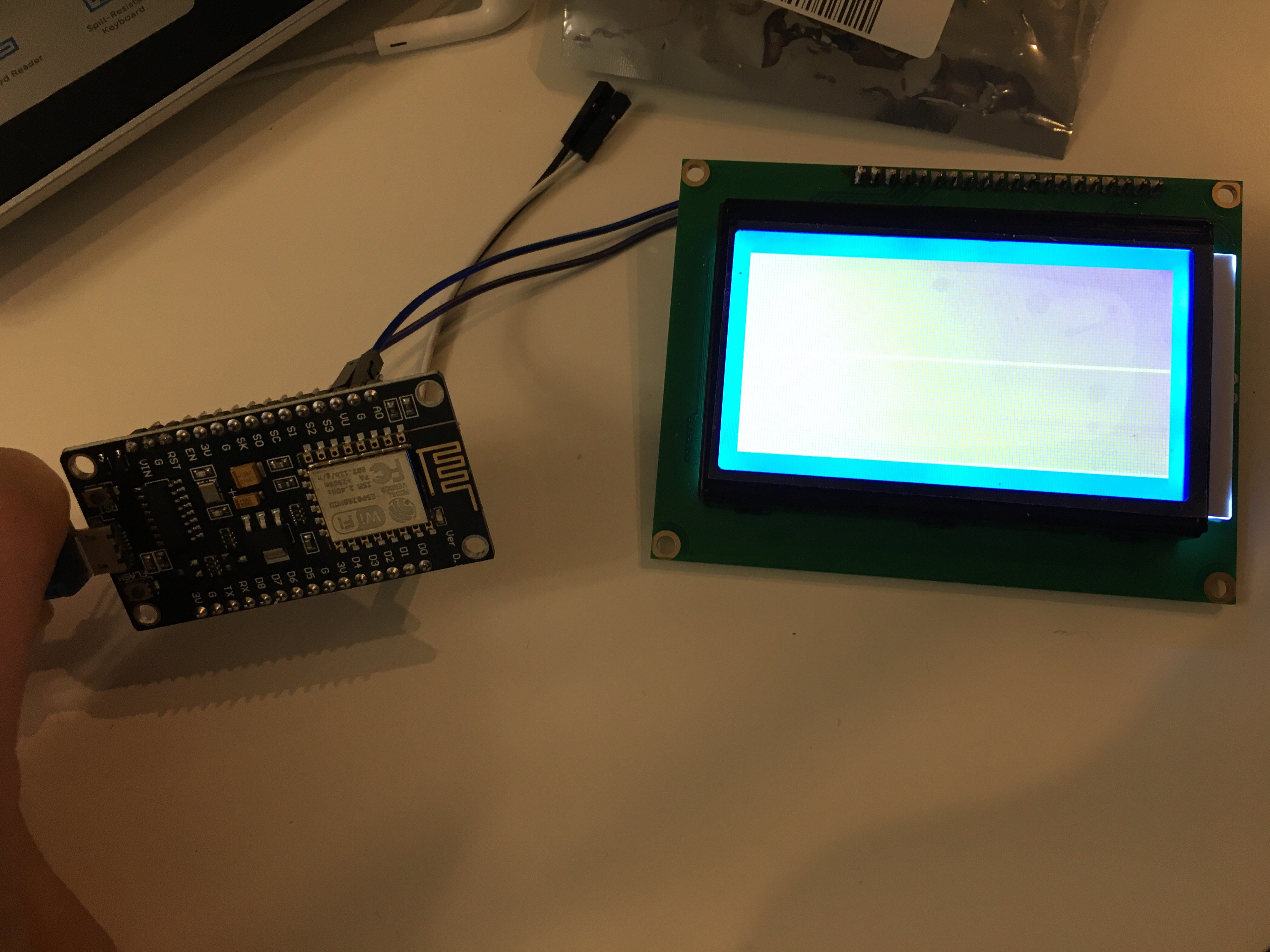

Hello,
i have lcd display 12864 i bought it here and iic interface. Also i download library from here GitHub - prenticedavid/Adafruit_ST7920_kbv: Adafruit GFX style library for ST7920 SPI display . It works on my arduino nano, but i can't compile my code to my NodeMCU board. When i compile my code on my nodemcu, i got error. What i can do with this and how i can fixed it?

In file included from /home/stasdell/snap/arduino/current/Arduino/libraries/Adafruit_ST7920_kbv-master/Adafruit_ST7920_kbv.cpp:252:0:
/home/stasdell/snap/arduino/50/.arduino15/packages/esp8266/hardware/esp8266/2.7.4/libraries/Wire/Wire.h: In function 'void twi_master_trans(uint8_t, uint8_t, int, uint8_t, int)':
/home/stasdell/snap/arduino/50/.arduino15/packages/esp8266/hardware/esp8266/2.7.4/libraries/Wire/Wire.h:70:13: note: candidate 1: uint8_t TwoWire::requestFrom(int, int)
     uint8_t requestFrom(int, int);
/home/stasdell/snap/arduino/50/.arduino15/packages/esp8266/hardware/esp8266/2.7.4/libraries/Wire/Wire.h:68:13: note: candidate 2: uint8_t TwoWire::requestFrom(uint8_t, uint8_t)
     uint8_t requestFrom(uint8_t, uint8_t);
/home/stasdell/snap/arduino/current/Arduino/libraries/Adafruit_ST7920_kbv-master/Adafruit_ST7920_kbv.cpp: In member function 'void Adafruit_ST7920_kbv::st7920BlitRect(const uint8_t, uint8_t, uint8_t, uint8_t, uint8_t, uint8_t)':
/home/stasdell/snap/arduino/current/Arduino/libraries/Adafruit_ST7920_kbv-master/Adafruit_ST7920_kbv.cpp:389:35: error: invalid conversion from 'const uint8_t {aka const unsigned char}' to 'uint8_t {aka unsigned char*}' [-fpermissive]
         p = buf + (row & 31) * 32 + 2 * x0; //rows: 0,1,2,3,... or 32, 33, ...
exit status 1

Yes i can, i connect lcd display to VU and here is 5v.

Of course the contrast works at 5V.
I asked you to try 3.3V
With 3.3v it is not working
david_prentice:
There is not much point in wasting time over ESP8266 I2C if VR1 does not achieve visible contrast with VCC=3.3V
You could connect VCC=5V if you remove the I2C pullup resistors. Contrast should be ok.
Connect I2C pullup resistors to 3.3V
If you are attacking the backpack with a soldering iron, you might just as well use a Dremel saw and remove completely.
Then you can control the ST7920 with regular 3.3V logic via the SPI interface.
David.

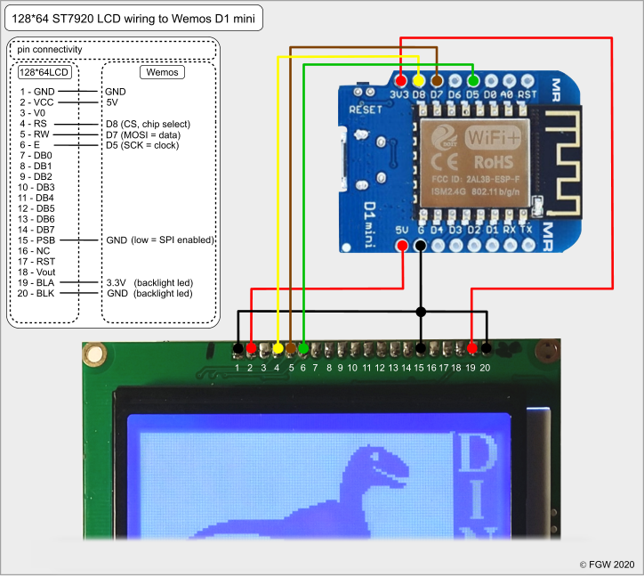

Hi stats,
I have connected a ST7920 128*64 LCD with a Wemos D1 mini, which is an ESP8266 similar to the NodeMCU
The library used here is u8g2 by Olikraus.
The description and sketches can be found at http://www.zonnepanelen.wouterlood.com/18-connecting-a-wemos-d1-mini-and-a-12864-lcd/
Success, photoncatcher

SPI ST7920 is the wise way to go for the ESP8266. You just need a Dremel saw.
Several libraries should work.
If you really want to use the I2C backpack - say when you will receive some resistors. I will fix the software.
If you want to use SPI - say when you will acquire a Dremel saw.

I have given clear advice.
i.e. run I2C backpack on 5V Uno, Mega2560
i.e. remove backpack and use SPI for a 3.3V NodeMcu.
I have asked questions about your tools, resistors, soldering, ...
If you answer them, we can advise you how to remove the backpack without damage.
If you don't want to answer that is fine. You are on your own.
If you don't know what a resistor looks like you should find a new hobby.
