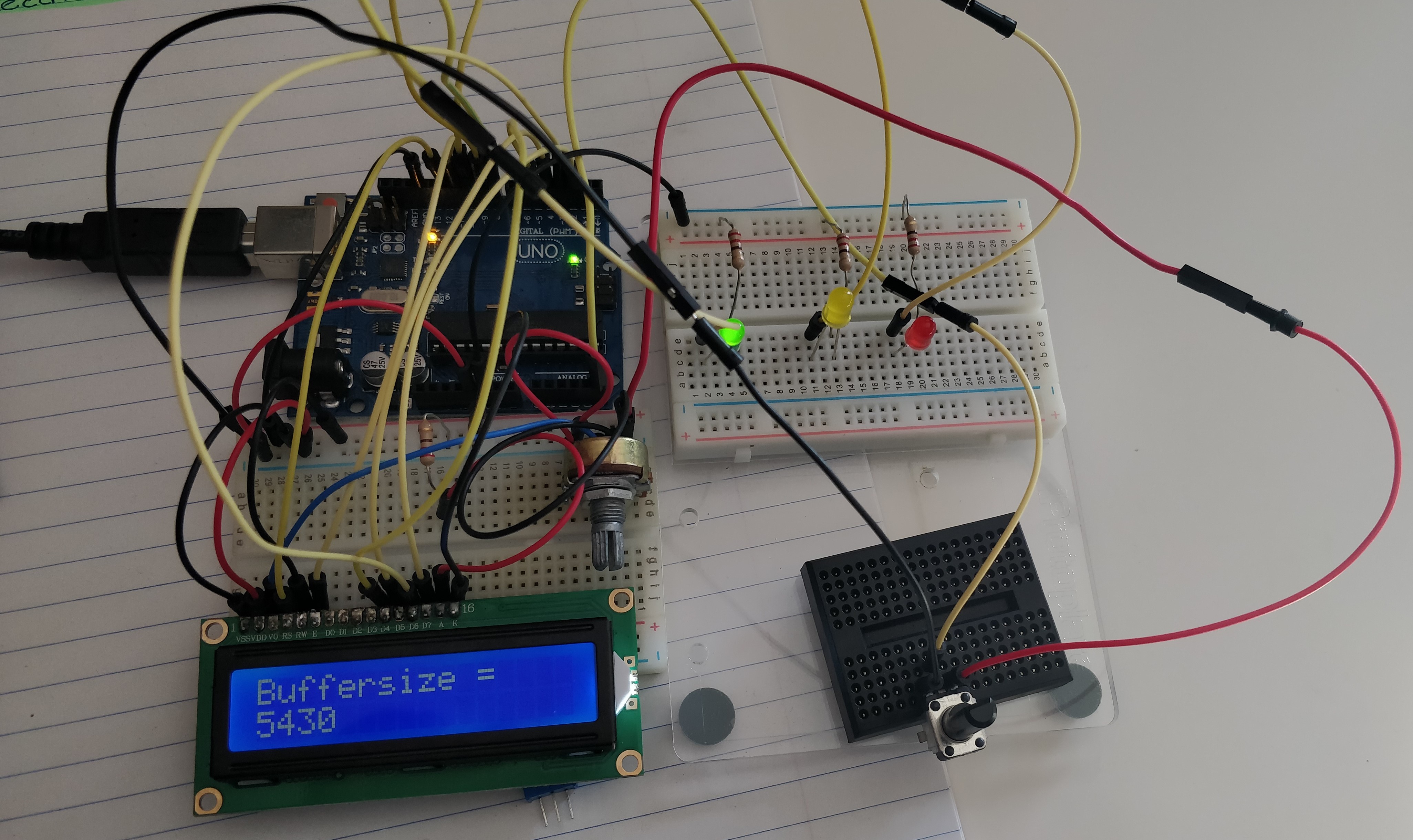

I want to display at my LCD screen a value from 2 till 5. This should be working by turning on the potentiometer. I have made a code which is shown below (and attached). The problem is that the LCD screen still displays a value from 0 to 1023. And actually when I rotate to fast, the value is over the 1023 (for example 5430). As well I have attached the setup of the hardware.

Shouldn't you print val, not potValue, there?

I have adjust it and it works! Thank you.

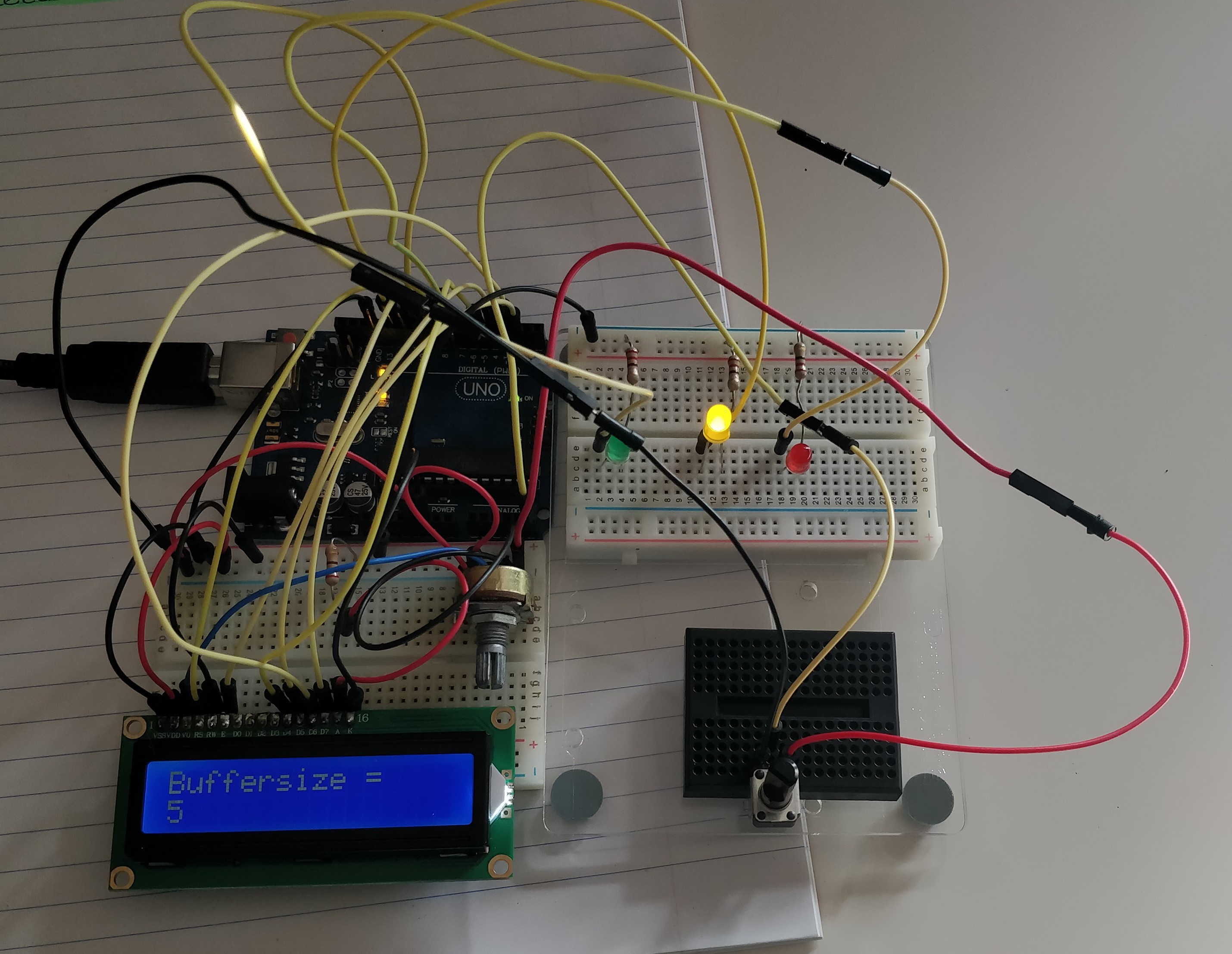

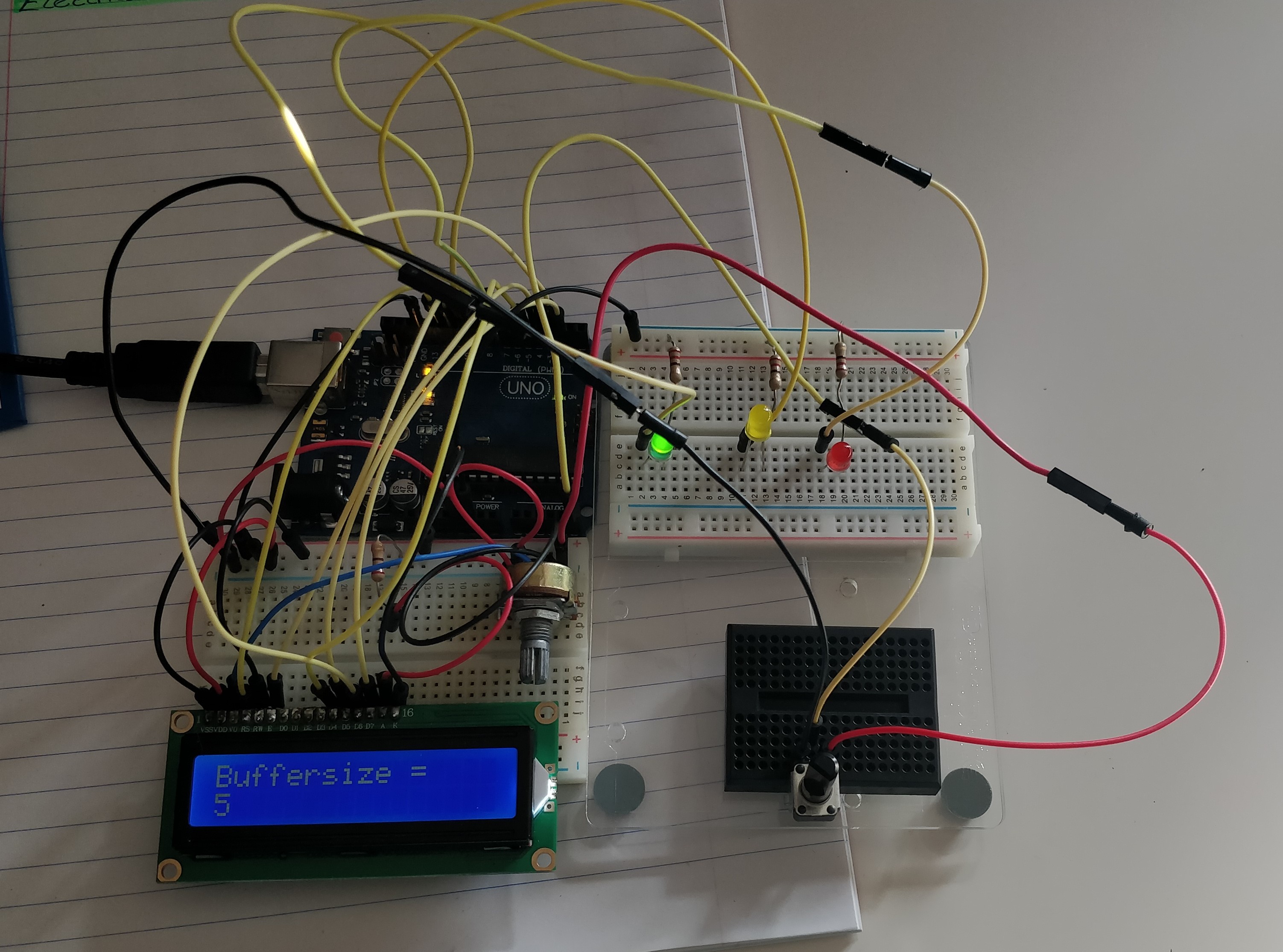

To come back at this subject. I have add a code to lighten up the LED's by wanted values. Almost everythings works fine except at the value of 4/5. At the value of five the yellow led is still lighten (actually blinking). See in the pictures attached.
What could be the reason for this? Has it something to do with a tolerance or...?

You are printing the value of val. What are the values? Do the values match the LEDs?
If there is noise on the pot input, place a 0.1uF cap from the analog input to ground.
If I understand you correct, the value's are 2 - 5. By the value of 2/3 the red light turns on, by the value of 4 the yellow light turns on, and by value 5 the green led turns on.
Thank you, I will take a closer look at this :wink:
