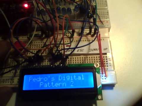

I have been trying out a few LCD examples lately and am now wanting to try an 16 x 2 LCD with a menu interface to move through four different LED patterns displaying on eight LED’s. Once again this is a learning exercise. I did have a look at and successfully implement Giuseppe Di Cillo’s “Manage menu and LCD display with Arduino” tutorial at http://www.coagula.org/content/pages/tutorial-manage-menu-and-lcd-display-arduino but could not work out how to modify it to actually control anything such as what I am proposing. What I envisage for example would be - 1. Opening message “Choose from the following four displays” > Enter 2. You are then presented with pattern 1 > down button > pattern 2 > down button > pattern 3 > down button > pattern 4 3. When you reach the pattern you wish to display you press the enter button and the selected pattern will display on the eight LED’s In essence this is exactly what Giuseppe’s code does but where his code displays “ you used Item1SubItem1” etc, I want it to run one of the four LED patterns. His code and circuit use four tact switches for enter, escape, up and down. Looking at the many questions asked after the tutorial might I be right in assuming that you can modify his menUsed function to run one of the four LED patterns by using a switch case coding or the like. I am not asking anyone to do this for me but rather to hopefully point me in some general direction that might help get me off to a start. As always thank you for taking the time to read this Pedro.
[u]Edit[/u] - I changed the menuUsed function to just blink an LED on pin 13 then return to the main menu, and that works :D So providing I can use a shift register, being controlled by three of the analog pins (seeing as the circuit as is, already uses digital pins 2 - 11 for the LCD control and menu buttons) to control my four LED patterns, my next problem is how to incorporate four different choices within the menuUsed function to implement the four LED patterns.

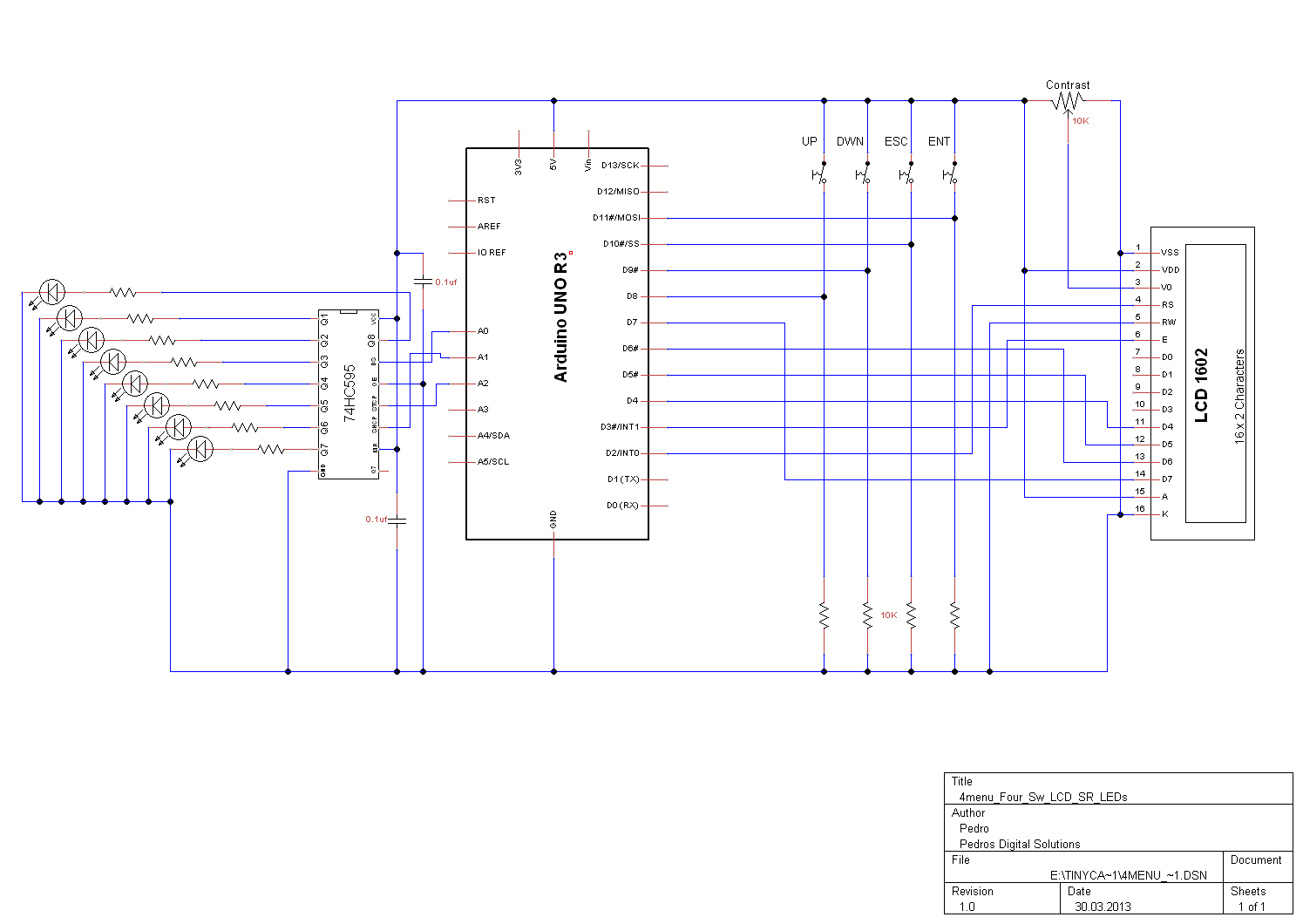

I have connected a 595 shift register to analog pins 0 - 2 and am using this to control eight LED’s, with the circuit attached. I have stripped the Menubackend code of all the menu items that I do not require, just leaving four MenuItem’s to interface with my four LED patterns (hopefully 8) ) and all the code looking after the switch movements and other menu functions. Where the original code displayed “you used MenuItem…” I have substituted some shift register control code that lights eight LED’s via my “digit” byte.
What I cannot work out is how to modify the code so that I can pick one of four code patterns tied in with each of the four menu items. I tried to incorporate some if and else if statements within the “menuChanged(MenuChangeEvent changed)” function in line 79 but that did not work…
Any suggestions would be greatly appreciated, thanks Pedro.

Hi Pedro, you’re almost there, you should define your led patterns and then affect them to your digit variable just before sending the data to the shift register:
#define pattern1 B11000000
#define pattern2 B00110000
#define pattern3 B00001100
#define pattern4 B00000011
void menuUsed(MenuUseEvent used)
  if (used.item == "Item1")
    digit=pattern1;
  else if (used.item == "Item2")
    digit=pattern2;
  else if (used.item == "Item3")
    digit=pattern3;
    digit=pattern4;

Thank you so much semicolo,
that did the trick, it works perfectly. I must be slowly learning a few things which is heartening :smiley: When you initially suggested using if / else if atatements in post #3, I had a look through the code to try and find out where I might incorporate them, but was not sure where they needed to go.
Just as a matter of interest, I changed the digit byte from byte digit = B10011001 to byte digit = 0,which still works but is this, how can I say, “more correct’ Also in the “menuUsed” function I felt that the for loop was redundant seeing as the shiftout code was not using it. It was only left there from some other coding that I had been trying within the SR operations. After I removed the for loop the LED’s only stayed on very briefly so I increased the delay between the two shift register operations to compensate. Why did the LED’s stay on for longer with the for loop in place? Was it that even though the for loop was not actually doing anything useful, other than taking up processer time and therefore making the LED’S stay on while the for loop was executed.
Now I want to try and work out how to change the four static patterns to four dynamic pieces of code like knightrider style and some other patterns that I have come across. Thanks again for helping me get this far and I will post any progress that I make Pedro.
With some invaluable help from semicolo, I have now completed my 16*2 LCD menu control of four LED patterns. I might just expand the menu to six items and then look for my next learning experience 8)
http://www.youtube.com/watch?v=20u6zRJz6Is&feature=youtu.be
