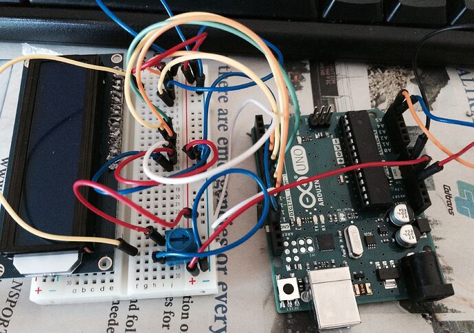

I am not able to get my LCD to work.
I am afraid i might had damaged the LCD during soldering.
Need help and advise from the community.
Attached is the picture of my project

You could be right.
But ...
Did you notice that you had your display plugged into one side of the breadboard, but all the connections on the other side?

OK, two steps.
Take it out in daylight but not in the sun to get a fully focused picture with the camera at least a meter away vertically above, using its zoom to frame the picture.
But first, if your contrast control is correctly wired to pin 3, adjust it until you see either characters or a line of blocks. This will be with the potentiometer turned toward the grounded end. If you see neither, try again with only pins 1, 2, 3, 15 and 16 connected.

i could not get the blocks of character... how can i fix it?
Seems like you now have the contrast set to a usable value, but I cannot quite figure out the significance of that display.
We need to know what you see with only pins 1, 2, 3, 15 and 16 connected (as much as I can see, it seems to have pins 3, 15 and 16 but not 1 and 2 connected, which makes no sense). If what you show in that picture was what you get with only pins 1, 2, 3, 15 and 16 connected, then it would indicate a faulty display. If however it is the result with the Arduino connected, then it may be either a connection or code problem and we would need to see the proper daylight picture that I mentioned.
We need to see your code - included in text here but in "code" tags.
