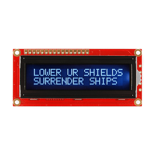

Hi there,
I'm using an Arduino Uno and an MQ-135 to detect ethanol and send readings on an LCD screen.
Everything works fine, until the reading goes above 100 and then dips back below 100 : the LCD adds a power of 10 to the readings from that point on for all values with 2 digits, for example : 90 on the serial monitor becomes 900. Readings above are correct (for example, 110 on the serial monitor becomes 110). The error only applies to the 2 digit values.
Here is my code :

Here is the LCD screen I am using. A datasheet is included in the page :
Thanks for your help.

The reason is that the display does not automatically erase the old text, but prints the new one on top. Once you move from three-digit numbers to two-digit numbers, one zero remains on the screen.
To prevent this, you can output two-digit numbers with a trailing space - that is, not "90", but "90 "
No it doesn't. What is happening is that the zero printed at the end of the value of 100 is not being overwritten so is still visible
The easiest way to fix this is to print a space after a value so that the previously printed zero is removed from the display

Thank you very much everyone for your help, it works great now!
The problem is resolved, but I was wondering why lcd.clear() in void loop() wouldn't erase the third character of a 3-digit number.
In your code lcd.clear() is in the setup(), and not in loop()
lcd.clear() will indeed clear the third digit along with everything else on the screen. This tends to cause horrendous flicker and is best avoided if possible
