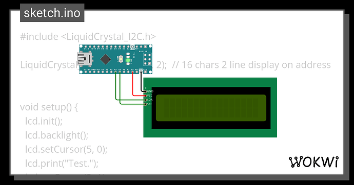

I want to make a program that says hello to the lcd screen. My lcd screen doesn't work even though I changed the arduino board. Although it's new, I don't know exactly where it is. I tried all of them 0x27 0x3f and so on. sry for my english
Did you turn up the contrast on the back? There should be a little pot there to adjust contrast.

Did you wire it correctly (i.e., used the SDA and SCL pins)?
Here is an example of a working set up.
yes scl a5 sda a4

This is the contrast pot. Did you adjust that? I've had at least one arrive in the mail and I couldn't see anything until I adjusted this. Turn it either direction and see what happens, it won't hurt anything.

Blue blank screen when I rotate it less, white rectangles when I rotate it more, and the result I want when I rotate it medium!
