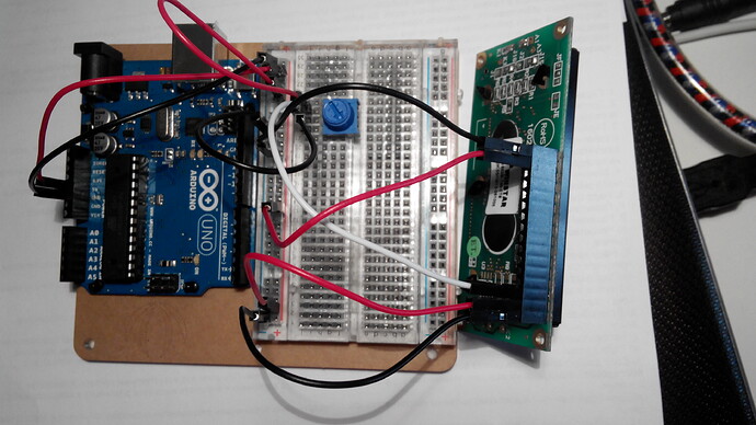

trying to connect the LCD in subject but cannot get any result with Arduino Uno rev 3.
Has someone idea if this LCD has some particular detail which I do not understand? Looking at the data sheet it seems that all is as per standard, but the only thing I get is the back light and nothing more (using the Hello World example).
It seems a stupid issue, but if I start with such problem at the beginning.......
Can anyone advice?
Regards
Orazio

hi, thank you for answering:
I attach two pics. One with connections and one with results. I did stop with power and back light, since the result is garbage. Following your suggestion I did not go ahead.

Your display has serious problems most likely due to poor connections between the LCD 'glass' and the pc board.
These connections are made by 'zebra strips' and there have been numerous threads with information about them.
The search capabilities of this forum software is abysmal, even if you find the camouflaged* search box. Try the following Google search: "LCD zebra site:arduino.cc".
Don

Hi Don,
you were, obviously, right. My LCD was simply garbage. No way to restore bending or pushing or whatever; just replace it at the first opportunity.
Meanwhile thank you very much for your assistance.
