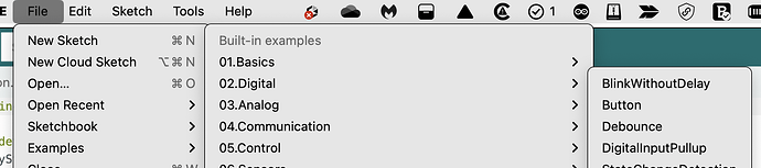

@Dave_Lowther has given you great advice. I just want to add that reading buttons and switches is much more complex than it appears. Check the built-in Examples, specifically Debounce, to understand the problem. Then go ahead and use any of the dozens of bounce or button libraries to handle the details, especially double, triple, long press, etc.
