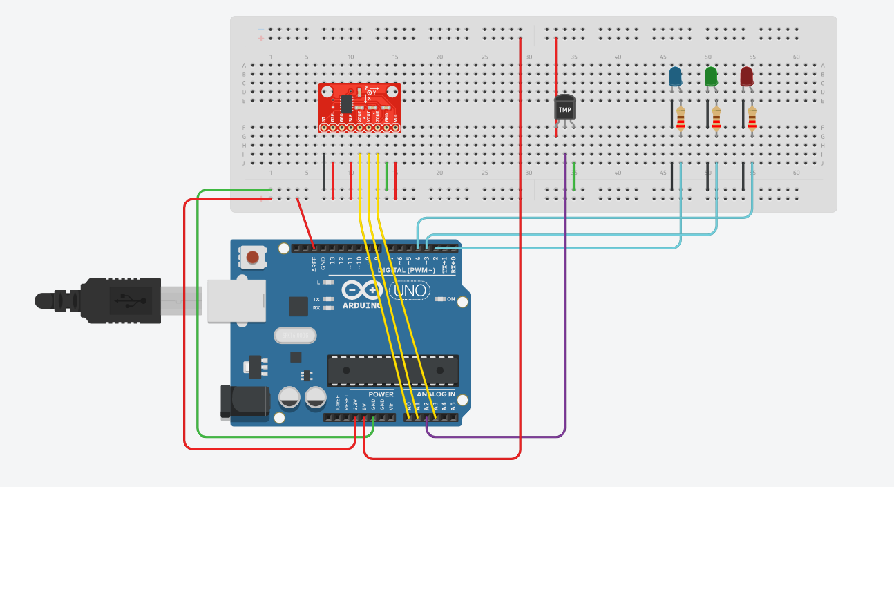

Hello! I am a beginner trying to make my code work the way I want it to. I am building a circuit on Tinkercad which is an online website for building circuits. What I am trying to do with my circuit is make the LEDs light up when the x-axis value on the accelerometer is 0 and the LEDs should not flash but should stay on. As of now this code here works but I do not know where to make the adjustments or what else to add so that I get it to work on how I want.

surrounding blocks of code with braces is unnecessary. i think you believe it's doing something it's not
within each block you have a 1000 msec delay. so loop repeat every 2 sec. only 1 delay is necessary.
what are the values of x, and tempF when you think the code is not working properly?
The tempF range the LEDs should light up is 90-120. This is fine. As for the accelerometer when x=0 it should indicate that the person is not moving hence if the temperature is within the range 90-120 the LEDs should light up which they are not. I have to move the accelerometer and then the LEDs will light up. Once the accelerometer goes back to x=0 the LEDs do not light up anymore.

not sure in which case, ovulating or not ovulating, the LEDs light up.
since x presumably represents some acceleration in a particular direction, the ovulating case will only be true while accelerating in one direction (i.e. x > 0)
since x is a float, i doubt its value is every actually 0.0000. it would be better to test that its absolute value is less than some small value (ABS(x) < 0.1) (don't remember if it ABS() or abs())
Thank you! That works now! I have another question. How can I create an array of all the temperatures recorded when the body is in resting state. That would be as we said abs(x)<0.1
I want this so that I can be able to store and calculate the average body temperature when the person is at rest.

decide on a array size, define the array and an index, capture values incrementing the index up to the array size
untested
   constant int MaxTemps  = 100;
    float tempFs [MaxTemps];
    int    idx = 0;
    if (MaxTemps > idx)
        tempFs [idx++] = tempF;
I tried rearranging and putting the code where I think it should be. However I am not sure if it is keeping track of different temperatures in the array and I do not know ow to check. I guess the next step after getting the array to work would be calculating the average temperature and would need a code like:

You've got a problem with your index variable "idx" - it gets reinitialised each time through loop().
Either make it global, or make it static.
