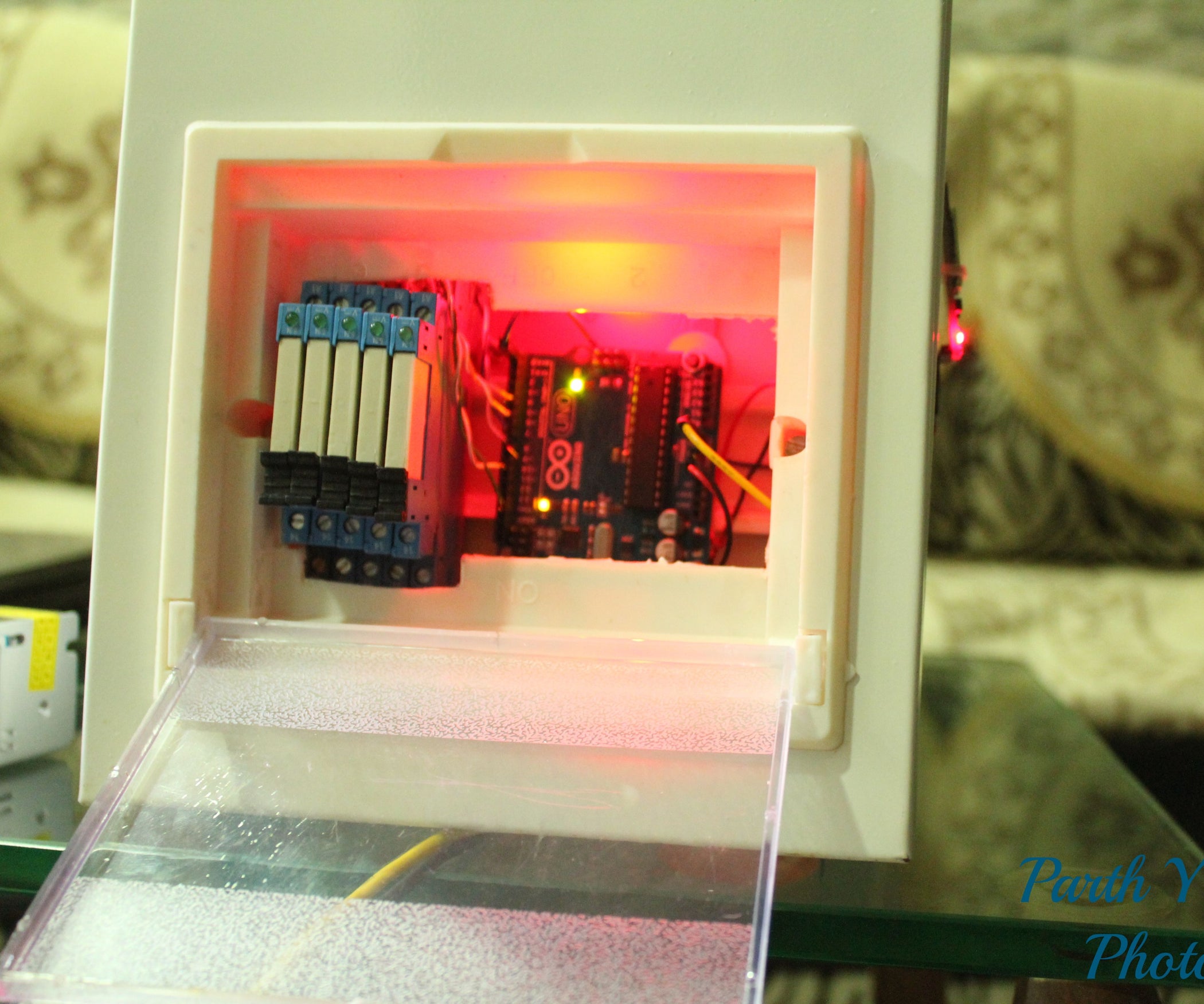

hello everyone,
i am planning to make a automatic stairs ligtning system for my new house.
but i dont know how i can do the coding i am not getting the start point of how i can code the arduino to the task i want him to do.
below are some videos of the idea how i want my system to work.
i want to make the things work like in the 1st video and then assemble them like in the last video.
pls pls pls
atleast give me some hints or tutorials how i can make it.
the bad part is just coding
thanks in advance :slight_smile:
Hi, interesting project!
Have you some components in mind? What leds will you use, what voltage and current do they need and how many stairs? What kind of detectors were you thinking? Beam-brake like that first vid, or ir movement detectors?
I would think a basic Arduino like uno will have more than enough outputs and speed, but I guess you will need some transistor or mosfet drivers for the leds.
Paul
hi,paul,
well my first aim is to build the prototype and yes ill be using the ir detectors like in the first video.
and i do have arduino uno,leonardo and some home build also with atmega8.
and i have 16 stairs at my house i was thinking , that arduino will trigger only 8 transistors and each transistor would have 2 led strips at output.
means almost 16 led strips almost of 1 or 2 meters.
and i first thought, that ill trigger the led strips with the relays but it would be quit noisy at night.
so i then thought to use the transistors or mosfets.
so finally can someone help me with the code. pls
the parts ill be using is :
tsop ir reciver or ir photoresistor X 2
ir led X 2
8 transistors
and 8 small leds just to see weather the transistor r active or not :wink:
and 12v led stripes
and arduino would also be powered with 12v
thats all
thanks in advance :slight_smile: :slight_smile: :slight_smile: :slight_smile:

Hi, I have what you are doing on my stairs controlled by an arduino and activated by 2 pir's one at the top and one at the bottom. If you like I'll send you the sketch that I used to program my stairs.
I would be interrested in that sketch as well ...it sounds very interresting.
BobD
Hi sorry for the delay been really busy, I'll dig out the sketch tonight for you. Email me if you like and I'll be happy to help. Darren@pcrepairswansea.co.uk
this is the basic sketch i started off with. customize how ever you like.

guys
everyone really thanks a lot for the help you all provided..
i was busy with some home automation project which i just now completed.
i'll soon post the information of the project but i don't know where i do post my ready project on arduino.
you can control all your house lights and fans including your setopbox and tv just with your android phone.
have a look at the link if anyone interested.
as soon as possible i'll even complete with the stairs light system
thanks a lot everyone
REGARDS
Parth Y. Temkar
