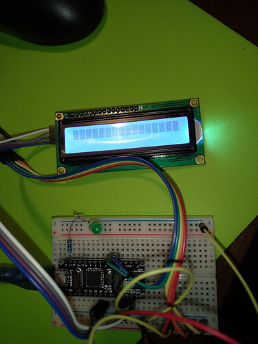

Thank you, the sketch compiles OK now. However even the LCD does not work :frowning_face:
This is what I see
test files i2c 16x2 LCD example with Arduino
confirm display is working
the microcontroller-world is not superstandardised like USB-devices.
You have to take care of more details than just "does the plug fit into the socket?"
And there are a lot of people online who don't care too much about sufficient documentation of their projects.
One reason might be the I2C-Adress of the LCD.
The Arduino-IDE comes with an example code I2C-Scanner run this code to determine the I2C-Adress of your LCD
If no I2C-device is found then there is something wrong with your wiring
You should provide a hand-drawn schematic. Under all circumstances avoid a fritzing-picture.
fritzing-pictures are
  • unprofessional
  • have a lot of non-relevant information
    and therefore hard to analyse
best regards Stefan
Well the author seems to have share unfinished code, that is also old. New IDE does not want to build it. I have managed to make it work.
I removed the
lcd.begin(16, 2);
Replaced it with the
 lcd.init(); // initialize the lcd
Also had to add
  lcd.backlight(); // turn on lcd backlight
The changes that you made lead me to believe that a different LCD library was used originally. There are certainly several with the same name and they have different functions
Seems I spoke too soon, the arduino code hangs if I have lcd code
// lcd.begin(16, 2);
Works after reset button press, fine. Hmm. What other LCD library I can try?
The hd44780 LCD library has a good reputation and its author (@bperrybap) participates in the forum
And that hd44780 library figures out the address on its own, and has various diagnostics.
It's in the IDE library manager.
