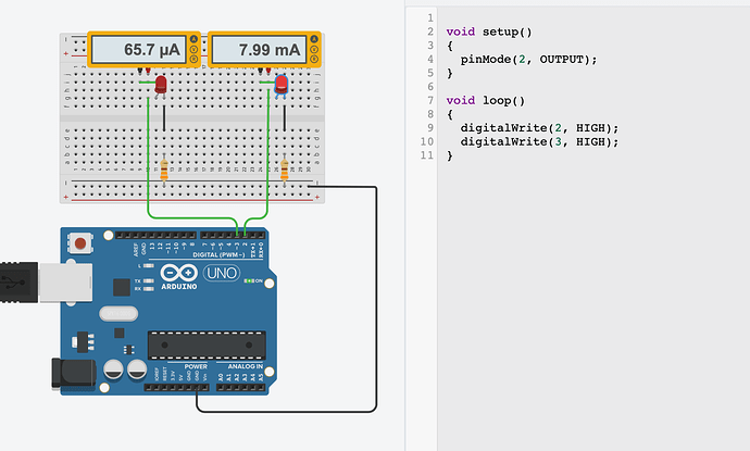

LED drawing 66microamps
I'm using a multimeter in order to test LED amparage on a automatic door system, and am finding stange results.
Why is the LED current draw so low? Should a LED be able to operate on such low current?
Ive tried the same circuit both on tinkercad and physically and am getting similar results.

What is the resistance? The image shows as brown-brown-brown, which would be 110 ohms IIRC, which, if the Arduino output is high, should result in 5-(~2.1)/110 = 26 ma. Looking at it the other way, if the output is high and that's a green LED and the current is correct, the resistance is 44 k Ohms. Depends, of course, on what the green LED's real voltage drop is at such low currents.
You're right, its a 110 omh resistor. Voltage measures at 3.65. So that would be 33mA right?
So why is it showing as 66Microamps? A reading that low cannot be a correct reading right?
Do you have the LED installed the right way around?
If you have a multimeter, measure the resistor. If the meter has a diode-test feature, use it to test the LED. Something is fishy, nobody's repealed Ohms Law, last I checked.
That current would be correct if the pin was not set to OUTPUT with pinMode().
Then you would only measure pull up current with digitalWrite HIGH.

@Wawa Nice spot.
My bad, folks, I didn't do the usual "Please post your code and your schematic", which would likely have resulted in a "PINMODE???? comment. I should have twigged to it when I back-calculated the resistance at something near 50k.
Lesson for the OP, post your code even when you don't think it's relevant. It invariably has some relevance.
Yup...

The green LED is set as an output, I only just made that mistake
I thought this had to be it, but after changing it I'm getting similar readings.
I give up. Please post your most recent version of code, along with correct and up to date "anomalous behaviour" that corresponds to that same version of code. No foolin', one more oopsie and I'll leave this to others.

To be clear, I don't give a rats patootie about what a simulator tells you when you've got available hardware. It's just another source of confusion, and another source of cut-and-paste errors, plus communications snafus when one person talks about simulator results while another is expecting hardware results.
  1. Does the LED work? Seems so, you've got some form of light emission, but I'd say wire it from 5v to resistor to LED to ground, and verify the resistor you're using gives the light you expect.
  2. verify you can turn on and off the digital output you wish to drive the LED with. Write a code that sets the output to 0, 1, 0 repetitively, with a couple of seconds delay between changes, and with a voltmeter, verify the output changes state.
  3. wire the LED to the output, and verify that it goes on and off.
This may seem insulting and boring, but we're at hour 20 now on a basic electronics step that should be resolved in 5-10 minutes. Something isn't jiving here.
the results are the same on both hardware and simulation.
I've tried all those steps and it works as expected.
I don't find it insulting or boring, If I did, I'd have probably gave up at this point.
