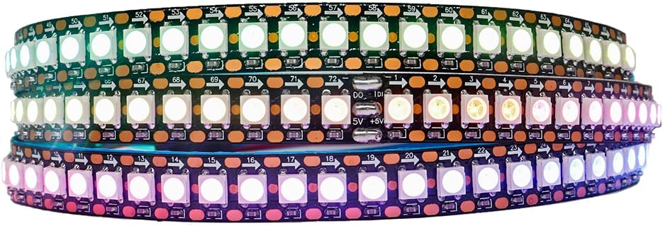

  • Get two meters of 144 pixels per meter WS2812 addressable LEDs for £10 Sterling per meter,,,
  • Cut 16 lengths of 16 pixels, wire VCCs, GNDs, "OUTs" to "INs"

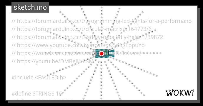

Here is a simulation of the same thing in 2D form (free).

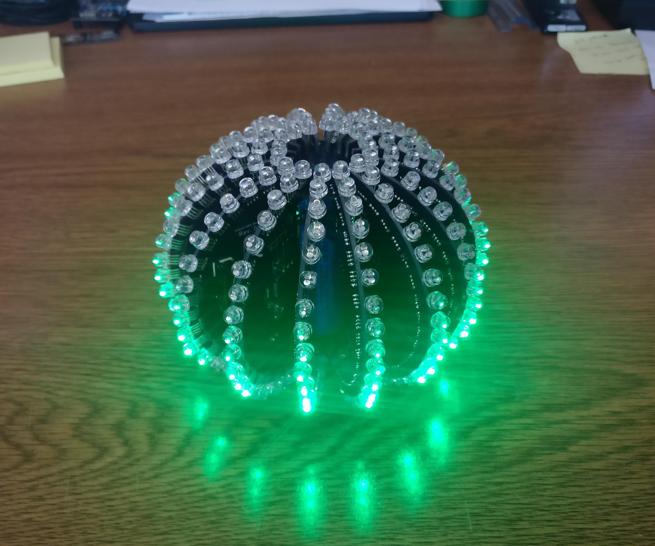

Here's Jiri Praus' HOLLOW sphere (very nice work):
Thank you, that video you shown I already have all the kit to make that one including the 3d printed template but I need a bigger easier version rather then what he does which individually soldiers each led to a copper ring.

Each "pixel" of the WS2812 contains three LEDs. Each LED at full-bright (255) should be estimated at drawing 20mA, so 60mA/pixel maximum. 100 pixels = 6A (6000 mA), and 200 pixels = 12A.
Also, each pixel draws the voltage down, so after 50 or 100, you need to "inject power"... which is to say, run a Ground wire and a Vcc wire from the power supply to the pixel string GND/VCC pads.
