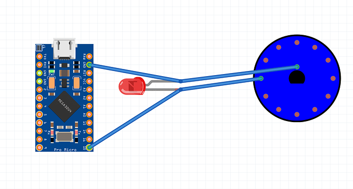

The issue I'm running into is that I'm trying to save as many pins as possible (the board is already a 5x4 switch matrix with the SP8T), while also trying to add LED indicators to the 8-way to show which layer is active. I do know that I can run each LED to pin and set high state as needed, but that requires more pins than I have available. I've tried connecting the LEDs as follows:
This works, but the LED remains on until you're on the selection, which turns it off. Is there any way to reverse this? So the LED is only on when the switch is active?

Regarding the LEDs. The wiper is connected to GND. Fine. Connect all LED anodes to positive and their cathodes to the rotating switch. By the way, there ought to be a current limit resistor in serie with the LEDs. Add it between the common anodes and the positive. Make sense?
I should have been a bit more clear, but the LEDs actually have the resistors presoldered on the wires!
If I'm understanding your comment correctly, that's how it's currently set up. LED anode is connected to the pinout (+), and their cathodes connecting to the wiper going to ground (-). Am I misunderstanding that? I do apologize, as when it comes to circuitry I'm a little green.
The cathode of the LED should not be connected to the wiper! Connect them to their respective radial pin on the switch.
I think I had my cathode/anode's backwards there :stuck_out_tongue:
So to accomplish this, would I connect the anodes(-) to something like the VCC pin for power, and the cathodes(+) directly on the switch pin? Again, sorry for all the questions - I really do appreciate you taking the time to work this out with me
Ooops. You have got the facts reversed. Anode is where the current enters the LED and cathode where the current leave, goes to GND.

You are an absolute SAINT!
This accomplished exactly what I wanted. Thank you so so much!
