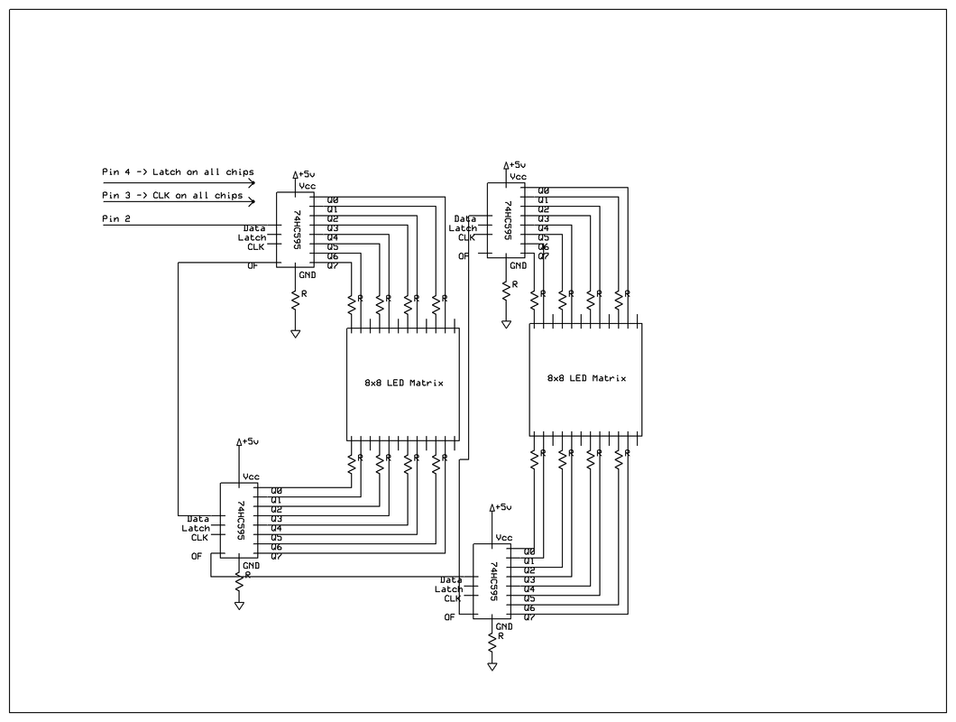

Thanks for the software, I have drawn my schematic and hopefully it will help you to see where I am going wrong.
I havent had a chance to change anything yet from the comments raised so far. But I think I would re wire it so a single shift reg controls all the rows through transistors and the other shift registers control the columns. Does this sound right? Do I need to change anything else?

I'll see if I can open your drawing when I get home.
Yeah, that drawing doesn't help as you don't show which pins are anode & which are cathodes.
Otherwise, you are on the right track, need transistors in there for current sourcing or sinking.
Ah yea thats me being lazy... The anodes are the pins with the resistors connected into them and correspond to the matrix rows.
I will draw up another schematic later with the transistors.
So this is how I am planning to re design my circuit: I have changed it so a single shift register controls the anode rows on both matrices, and the other four shift registers sink the cathode side of the matrix there are 16 green columns and 16 red columns across the 2 matrices.
Do you think this will work?
Not without transistors it won't.
The ULN2803A is a transistor array...
Yes but they only sink not source.
You have nothing to source current.
Add pullup resistors to the outputs of the ULN2803 and you will be all set.
Shift out the cathode info to the the 4 Sink shift registers.
Then shift out 1 anode driver, pause then clear the anode driver.
Shift out next set of cathodes. Shift out 1 anode driver, pause then clear the anode driver.
Repeat for the next 6 rows.
If you decide that you would rather control the display in columns, add ULN2803's to the other shift registers as well.
Then, drive all the anodes high low as needed, sink 1 cathode, pause, turn the cathode off.
Drive the anodes, sink next cathode, pause, turn the cathode off.
Repeat for the next 14 sets.

Yes pull up resistors on the ULN2803, so outputs aren't floating and kept high when the transistors are off.
Grumpy_Mike:
This would only be an issue if it was multiplexed by columns. If he multiplexed them by row, as CrossRoads's first example describes, then each channel on the 959s will only ever have to illuminate 1 LED at a time. If it was done by columns then each channel could potentially have to power up to 8 LEDs at once. Multiplexing by rows would be a better choice in my opinion. Plus the code will be easier to modify should he ever want to add more LED matrices.
Outputs do not float, only inputs.
These are open collector outputs, they only pull down. Any source current has to be obtained through a pull up resistor.
