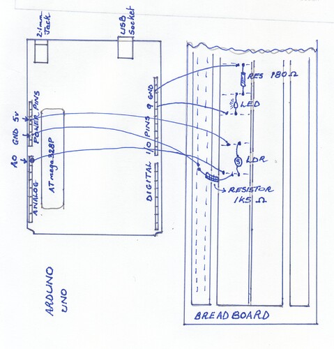

Thank you again to those who have made comments and suggestions.
I have included an attached diagram (rough).
I have tried or modified the following:
  1. pos pole of LED on other digital pins (same result)
  2. varied 'analogWrite to digitalWrite and vice versa (same result)
  3. Tried a diode (IN4007) in front of LED as suggested by cjdelphi (no LED result)
  4. adjusted resister on LED to 180 Ohm (using ohms law) - anable current of 0.028mA (suggested bt lar3ry)
  5. tested LDR further on multimeter and changed resister to 1K5 ohm (same result)
  6. Varying 'brightness' is effective via analogWrite only, but remnant LED glow remains as long as 'brightness' is > 175). If 'brightness' <= 175, the LED fully extinguishes. If set to digitalWrite after line 'if (val > 500)' 'brightness' seems ineffective (ie. LED lights fully ie. HIGH) and does not extinguish at end of sketch (LED reads 0.44v)
  7. circuit pulled apart and re-constructed (same result)
At end of sketch, when I measure voltage between pos LED and gnd it is 0.44v ??? If I remove the LDR, the LED extinguishes fully.
My initial post indicated that this was my first post and I am new to Arduino. I am no doubt doing something that is obviously incorrect.
In appreciation of any helpful comments
rmbsj160
I haven't time to have a proper look, but here's a thought: if that's a long, full-sized breadboard, the power rails are often broken in the middle, depending on make.
Can't tell from your sketch exactly where the things are plugged in, but seeing as you use the power rail, could it be that the wire from the Arduino ground, which goes to one side of the resistor, doesn't actually meet the resistor if they're opposite sides of the break?
