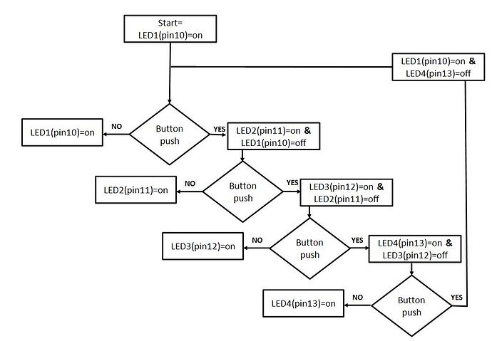

Hello again, I made an prog flow for better understanding what I want to know. I think there are a lot of ways to do that, how I can programm like the flow is show the correct state? Is it possible that someone show me a sample to do that?
Thank you

When you have two or more variables that are consecutively numbered it is often a good time to use an array. In this case:
const int LEDCount = 4;
const byte LEDPins[LEDCount] = {13, 12, 11, 10};
Then you can then use a 'for' loop to act on each pin:
for (int i = 0; i < LEDCount; i++) {
    digitalWrite(LEDPins[i], merker == i);  // The one in element 'merker' is on/true/HIGH, the others are off/false/LOW

The sketch won't compile. You took out the definition of the names LEDPin13,12,11,10 but still left them in the code. When you switch to an array you should use it everywhere, including setup().
const byte ButtonPin = 2;
int merker = 0;
    digitalWrite(LEDPins[i], LOW);
    pinMode(LEDPins[i], OUTPUT);
  pinMode(ButtonPin, INPUT_PULLUP);  // Connect button between pin and Ground.  LOW means pressed.
  static boolean previousButtonState = HIGH;
  static unsigned long buttonChangeTime = 0;
  boolean buttonState = digitalRead(ButtonPin);
  // Look for, and debounce, button state changes
  if ((buttonState != previousButtonState) && millis() - buttonChangeTime > 10) {
    previousButtonState = buttonState;
    buttonChangeTime = millis();
    if (buttonState == LOW)  // Button pressed
      merker = (merker + 1) % LEDCount;
:slight_smile:
