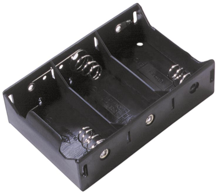

You could also use 3 "D" Cells in such a holder http://www.memoryprotectiondevices.com/img/BH3DL.jpg to see how long they last. According to here, Alkaline "D" cells can have a capacity up to 12000 mAh. List of battery sizes - Wikipedia
You have other options for batteries as well like lipo which might be more appropriate for a "wearable" system.
