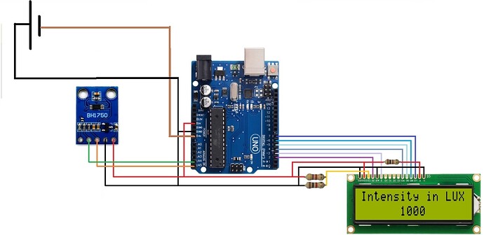

Hello,
I'm trying the get the LED in digital pin 13 to turn on when the light is below 1000 lux. I've included a LCD screen that displays it clearly but can't get the code to work.

You have no pull-up resistors on the I2C lines. You should use 4K7 on each line.
You are not even making any attempt to write to pin 13 in your code.
Please post your code using a code block.
I can't see in your code where you are even attempting to turn on the internal LED.

OK but not addressing what I asked about in post #7
 'void loop()':
sketch_apr04a:41:5: error: expected ';' before 'digitalWrite'
     digitalWrite(LED_PIN, HIGH)
exit status 1
This report would have more information with
"Show verbose output during compilation"
option enabled in File -> Preferences.
This bit of code is wrong. the digital write should have a ; at the end of it
and
value < ANALOG_THRESHOLD
should be in an if statement
if(value < ANALOG_THRESHOLD)
then the else will reference this if and not the first one.
