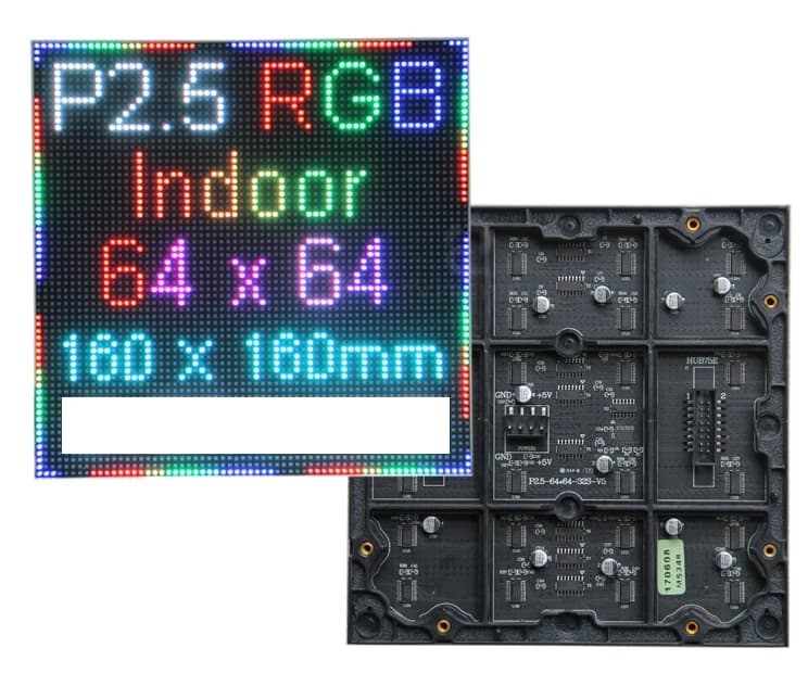

Hello. I am trying to figure out how to build an LED wall for scrolling text. I have seen the 64x64 RGB panels, the 8x8 red ones, and I could even consider starting from individual soldered LEDs. What I am trying to understand is what is the maximum size limit of the matrix that I can ideally reach.
